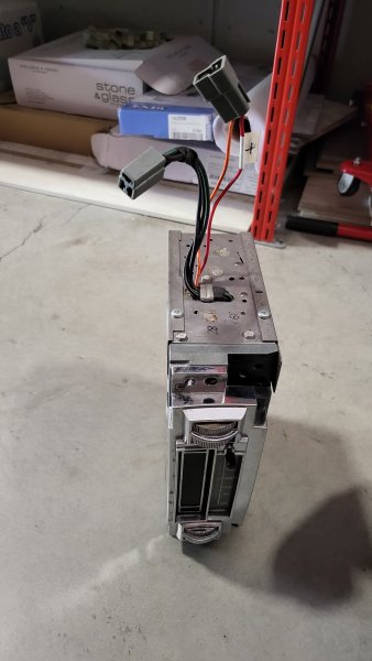

if by plate you mean the bezels, I can confirm they are different. You can buy an 8 track bezel online, easy to find. On the other hand, while I cannot confirm, I am almost sure the radio and 8 track use the same mounting points in the metal dash support.
For wiring I have attached a pic of my now defunct original 8 track (wasn't worth the shipping cost to the US to have it done by Barry, so I bought another one from the States).
Hope it helps!
