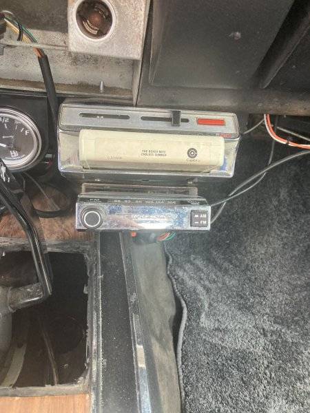

I didn’t even hook my radio up. I just put one under the dash, wired it into an equalizer/booster, I have 2 6x9s in the package tray, and 2 4” in the dash. It’s amazing how good it sounds!

This ^^^ was the common look back in the day. We'd do under dash 8-track installs, most times with the slide-out mount so you'd take the unit with you when you parked the car. A couple of Jensen 6x9 on the shelf, a couple of small rounds in the kick panels, and you're ready to rock.

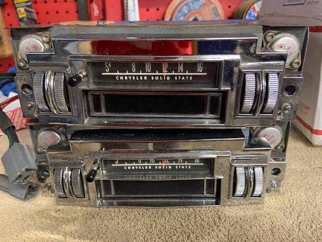

I have one I believe. DM if you want to discuss. Has Dodge face plate but understand it’ll need to be gone through like most people send out

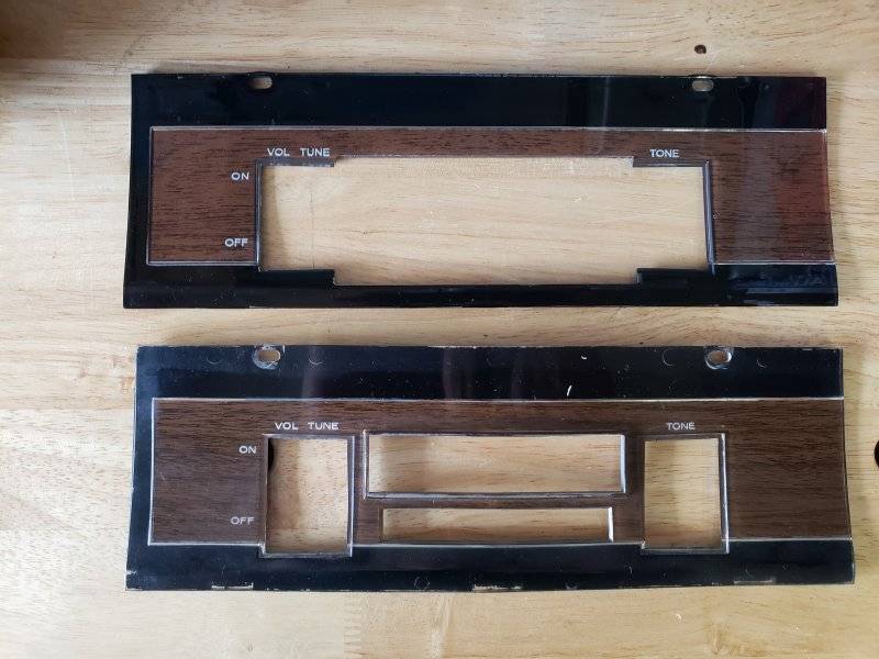

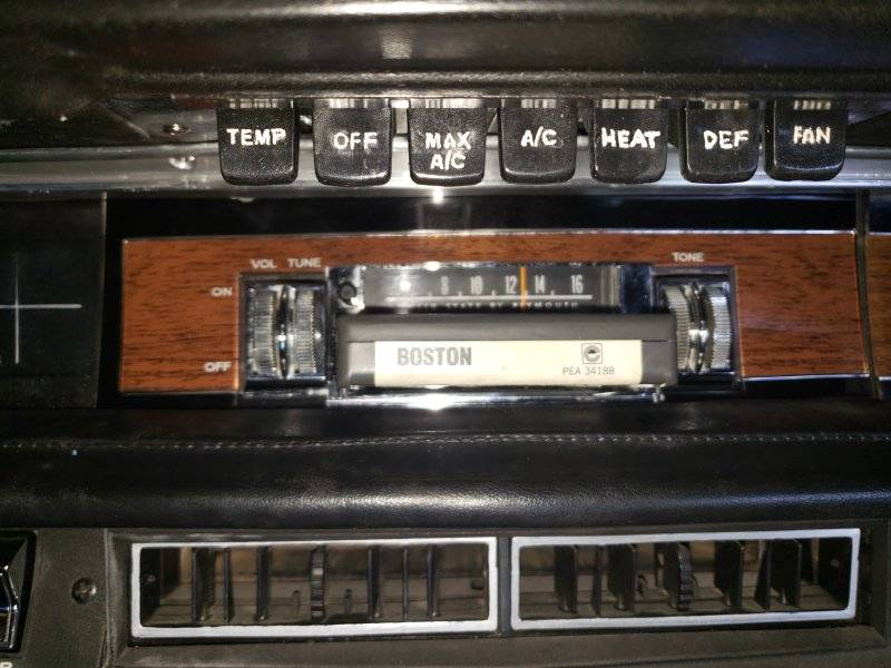

Glad to see some one else helping keep the 8 track alive. I did this a couple years ago and if you can get one already repaired i would go that way i had to have mine restored works good but it took about 8 mounts to get it done and lots of $$$. If you have the rally dash you should be able to get a bezel for it but if like me you have a standard dash you have better luck winning the lottery then finding a bezel that is why i had to make mine for my 69 GTX. The one thing to consider is do you want restored Factory witch is AM 8 track only or like i did Factory case but upgraded electronics to AM FM 8 track with blue tooth aux input HD radio. Either way you will love it when you are done. Usually i have Styx's Paradise Theater or AC DC Back in Black but you can see in the picture you cant go wrong with Boston either.20210521_122558.jpg20220521_160131.jpg

My go to Journey Infinity. 800+ 8 Tracks here lol. It’s cheap music. Only 8 months? How about 1 year and paid extra to be bumped only to send back because it played 4 tracks at once and then waited another 2 weeks. They forgot to tighten track screw they said.

Love t!!!! You should post how you modified it and share. I’ve been asked several times by wood grain owners
I took a stock radio bezel made a fixture to hold it reversed engineered the dimensions and cut it out on my CNC mill. I made 3 of them just in case i had an issue but the one i have in my car is the first one so i have a couple extras in my hip pocket just in case for a back up. It was not to difficult to do it just took a while to come up with right numbers to cut it to.
