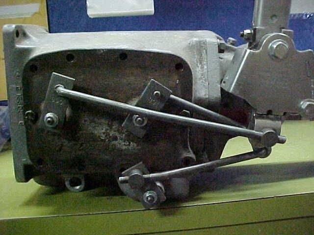

Looking for a picture of 4spd shifter linkage 69 Roadrunner swapping my car over to a 4spd bought used 833 with used shifter bought dog ears from brewer think the 967 is reverse 891 2/1 and 068 4/3 ,I saw a picture some just can’t seem to find it again thanks Gregg

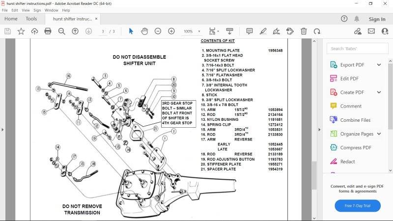

Installation Instructions
Hurst Competition Plus Installation Kit
Fits: Dodge, Plymouth & Chrysler w/New Process Transmission
1. Remove the boot and console. Remove the stock shifting linkage.
2. Install the mounting plate on the transmission. Tighten the 3 flat-head socket screws evenly.
3. Place the spacer plate on the mounting plate. Install the shifter on the spacer plate and tighten the
mounting bolts.
4. Assemble the rods and arms using nylon bushings and fasten with spring clips. See the exploded
assembly view for proper parts combinations. Screw the rod adjusting buttons onto the rods, to the
middle of the threaded length of each rod.
5. Bolt the stick to the shifter and tighten both bolts.
6. Install the arms onto the transmission shafts. Refer to the exploded assembly view.

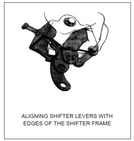

7. Align all three shifter levers at Neutral by grasping them between the thumb and forefingers and
aligning all three levers together with the edges of the shifter frame. SEE THE ILLUSTRATION.

These are the original instructions for a Comp Plus Hurst shifter installation. I hope they're clear enough to be useful.
It's in PDF format originally and this site doesn't allow me posting those type files, sadly.

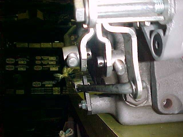

Dan Brewer actually took the time to mock me up some shift linkage to take some pics back when
I was trying to figure things out myself. These are those pics:
shifter linkage from brewers 2 3-27-17.jpgshifter linkage from brewers 3-27-17.jpg

Thanks I’ll give it another try ,my shifter doesn’t pick up reverse,I have tranny on a milk grate ,trying to set it up before I install it ,swapping my 69 Roadrunner over to a 4spd thsnks
