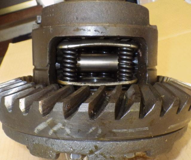

Heres a 9.25" SG unit out of my '74 Trail Duster..................

BTW, the SG picture I posted is an earlier one out of a '74. It was repaired by a Chrysler dealer in the mid 90's so it went about 20 years before it broke. Just sitting on a shelf now, lol.
