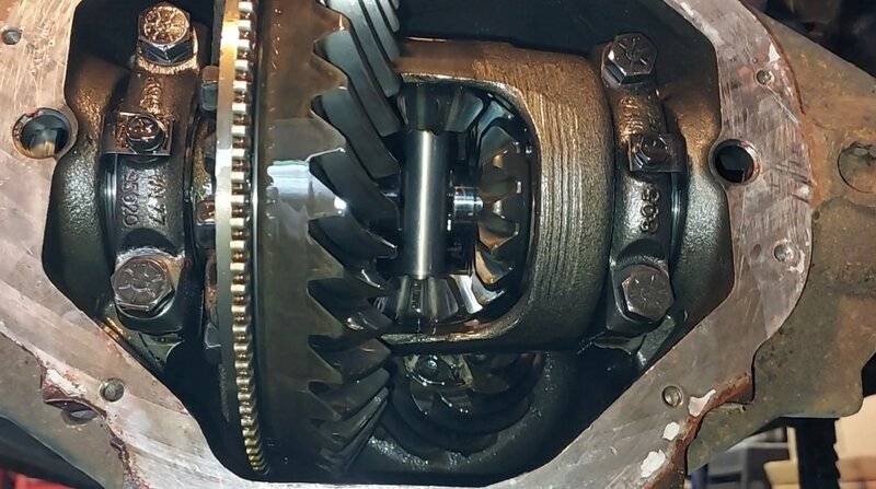

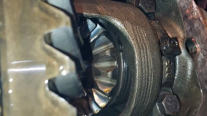

I'm rebuilding one at the moment. 2003 Dakota with the 3:55 and "Trac Loc".
These are known for bad pinion bearings and the clutch packs can be problematic with broken clips and locking disks.

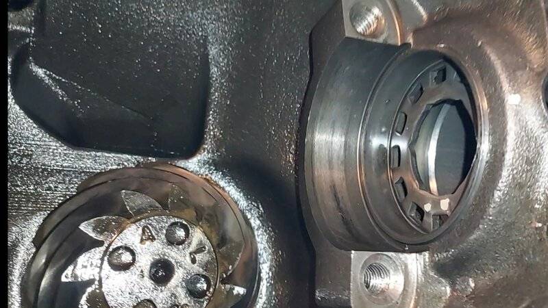

The preload on the carrier bearings are adjusted with a special tool that has to reach down through the length of the axle tube and fit the hex designed in the adjuster. The tool can be bought or you can make your own.

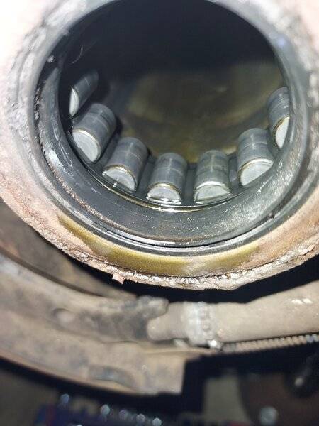

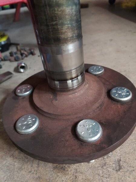

Axle bearings are open roller dependent on lubrication from the differential. The roller bearings run on the axle shaft itself without a race.
