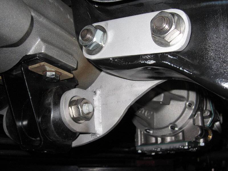

Can you fabricate? If so, cut the mount section off the cross member and build new mounts for a spool type trans insulator ( used on 70s models). Poly insulators are available for this style. I fabbed the entire assy for my 65 but, I moved the engine back as far as possible w/o cutting the firewall.

I have the Alterkation front suspension and ordered it with big block engine mounts. After getting my new Indy Max 540 from Muscle Motors I realized the block utilized hemi mounts and called RMS. Bill was kind enough to send me new hemi frame brackets (free) so I cut off the old and welded on the new while sliding the engine back as far as I could. That required some creative design on the trans cross member. I think if you used a 66-70 K-member you could duplicate my setup (and gain the better idler arm mounting) along with a rearward move of approximately 1 3/4". Bonus radiator clearance too!
