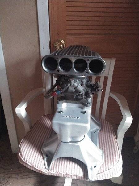

This motor's gonna have some trick stuff on it, check out my Weiand tunnel ram
I do not like one carb trs
i'd go with small primary TQs if they fit a dual quad top
