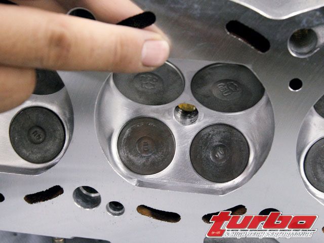

Which foreign motors are quench, the 3v and 4v set ups is what makes them efficient and the chambers don't have any provision for quench.......
Here is but one of MANY examples. This is a Nissan head. Note the quench pad. See the FINGER? Lots of 3 and 4 valve motors are quench motors. My wife drives one everyday. The 3.0 Duratec in her Escape is a prime example. ...and you do what for a livin again?
