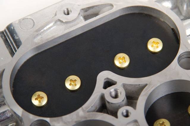

Demon 'Street Demon' 625cfm Spread Bore Polished Vac. Sec. Elect. Choke 4bbl #333-1902 #6.jpg

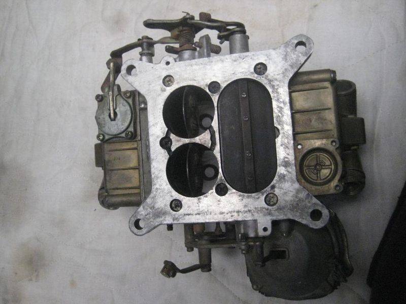

Vacuum secondary 950 3 bbl #4915 IIRC, 30cc pump

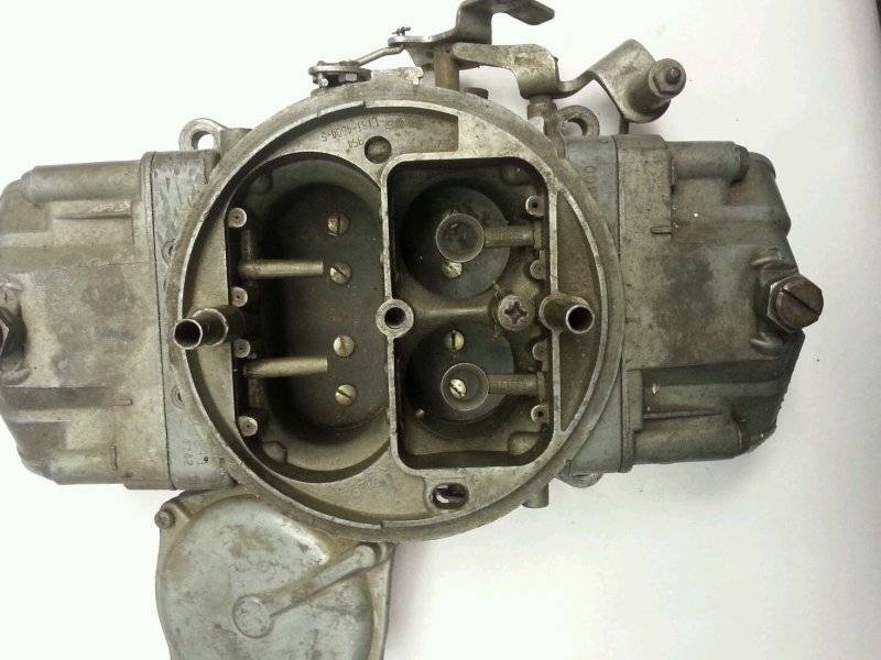

a different one #4604 (1,050cfm)
off hand I don't really remember what was different between to 2 vacuum carbs
other than 'flow rate' & a 50cc pump
the one above had a choke horn & manual choke

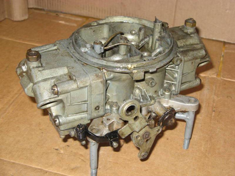

dbl pumper below, it's not the one I used
this had a strange squirter nozzle
most of mine had a 50cc front pump too,
stepped up the squirter nozzles to like 37-ish IIRC, with down legs
hollow screw too
I think it had a plane jane #31 from Holley org.
like most of them do
