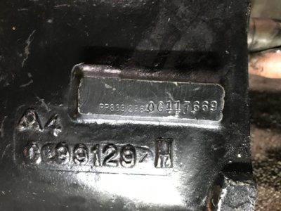

Hi Guys, I got the trans out with the help of your good advice, I think i learned a few new cuss words during the process Hate to bother again but if anyone could take a look at this pic and let me know if it is an original vin or does it look like it has been tampered with, some of the small numbers at the bottom have been punched over not sure if this happens in these years?
Maybe that's a stamp from a rebuild? The number should match the last numbers of your VIN tag on the dash of your car. I like Fran Blacker's idea about the bolts, but I just use 2-3 different length bolts during installation. You're just holding the weight of the transmission while you shove it forward (so you can get under/around it where the jack was holding it up). It can take quite a bit of wiggling/shoving/cursing to get it back in. TAKE YOUR TIME with the clutch disc alignment tool & it will make installation easier.
Thanks PurpleBeeper, I purchased this car and drove it last summer. it was fully restored or redone i guess about 9 years ago and i was told trans was rebuilt so this would seem logical, If they rebuild them they re stamp if they change stuff inside like gear ratio ? I have so much to learn, i was hoping this would remain turn key for a few years before i got into all this. but thanks for all the information.
