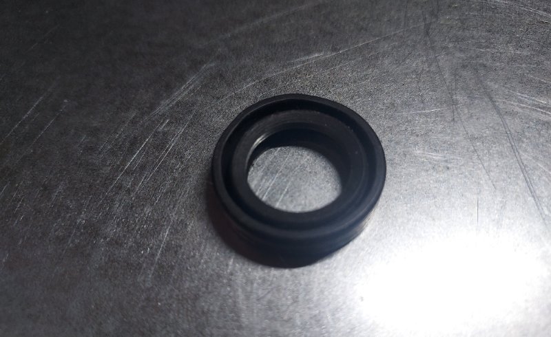

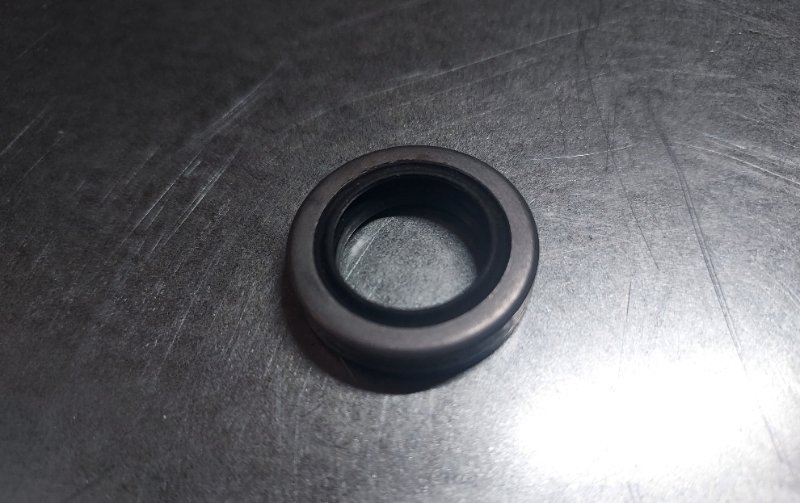

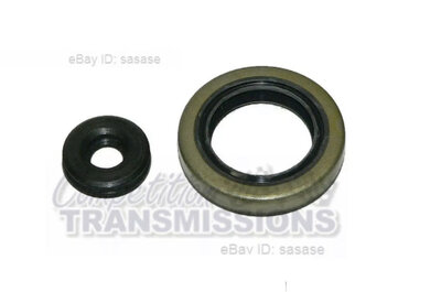

Below picture of the seal I was able to remove but under this there doesn’t appear to be a seal of any kind- this sits recessed in the case. Not like the second picture?
Was there any model differences that I’ve missed?

Are you sure? The lip on the seal should point down.
Install this side up...
This side down...

This a metal clad 66 and up case seal. The 65 and earlier uses the smaller seal with no metal that seals the throttle shaft in 66 and later valve bodies.

I understand what year, I was questioning the orientation of the seal itself. Most seals will have the lip towards the fluid or grease. Mike states the open side goes up. I'm not sure what he might be saying.
I just grabbed a random seal to show the solid side versus the lip side.
If you look at theinside of the seal you will see the lip. Mike is correct, groove/open side up.
