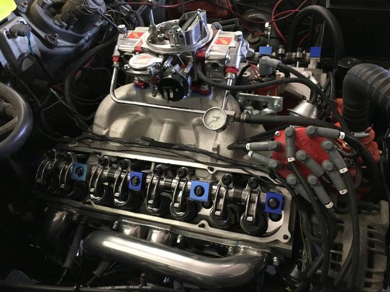

Hi everyone,
I have a new 522 stroker engine that I’m finally turning over but it runs very rough and won’t idle. I’ve checked everything I can think of. I can barely keep it going by staying on the throttle a bit and then it stalls and I get a big puff out of the carburetor.
It has brand new gas, fuel bowls are in the middle of the sight glass, fuel pressure flutters between 6-9, I’ve adjusted the curb idle screws, adjusted ignition timing, distributor is installed correctly, no broken rockers or springs, firing order is correct, and spark plugs look ok (though they now smell like gas and are black after trying to run it). I’m wondering if it’s dumping fuel for some reason.
I can’t seem to attach this 10 sec video. The file is too large.
Any help would be much appreciated. Thanks guys!

I have the vacuum ports capped on the carburetor, including the large one on the back. I did loosen the distributor and try turning it a little in either direction but did not get a significant change. Eng came with distributor already installed where they ran it and the carb is the one that was test on the engine too.

Engine was dyno tested at the machine shop before delivery. It’s all the way out in South Carolina so I was not present. I’m in CA.
Spark plugs are currently dark and smell like fuel.

The pressure gauge is fluctuating between 6-9 psi. I haven’t got it running enough for it to smooth out, but I might want to do a regulator of some sort.
