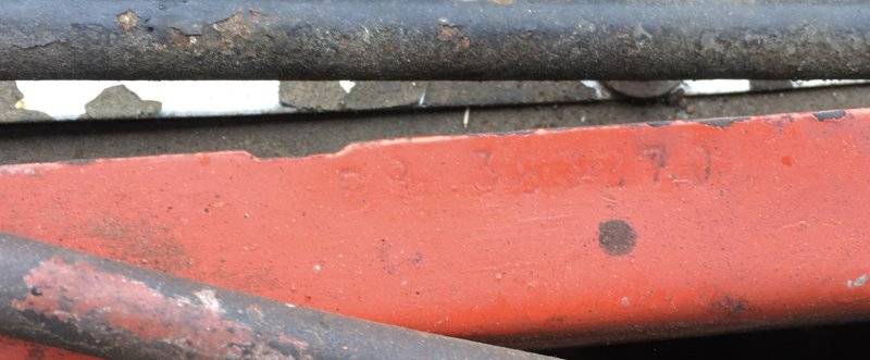

When I saw the stamped VIN on the radiator support I thought that is in the area of where a legitimate Daytona Charger would be. The first group of 500 cars built said XX on the dash VIN,but XS other fender tag. The 500 I had said XX on both the VIN and the fender tag. It was built December 4th 1968. The Daytona appears to be ligit!

Going by the radiator support vin it was the 65th car built so that would have been well outside of early or mockup “mule” cars.
I would say no based on that.

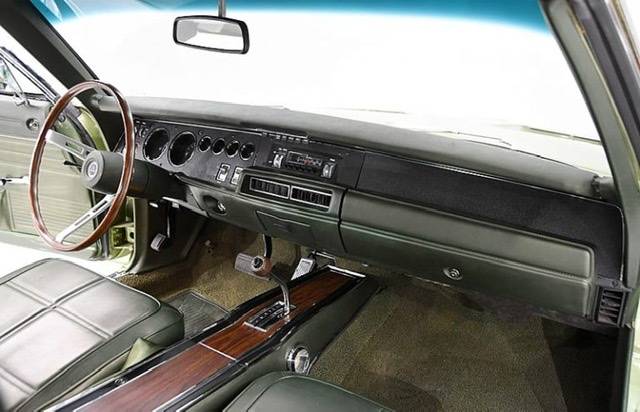

‘69 Charger dash with factory AC(vents in dash)

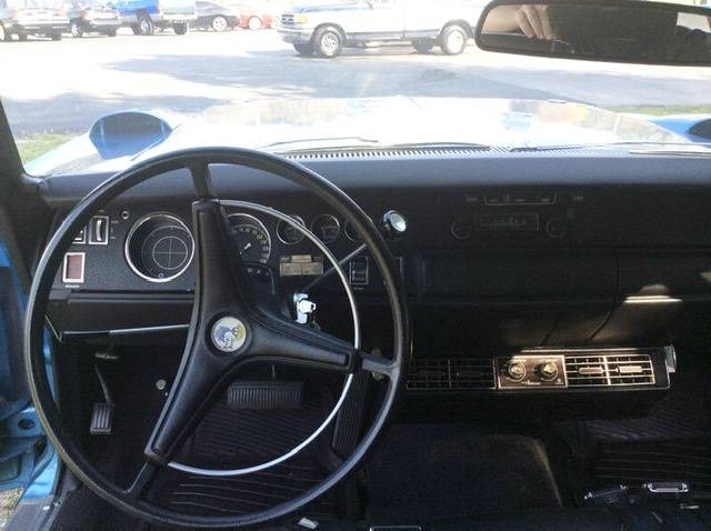

‘70 Superbird w/dealer installed AC(vent unit mounted under dash)

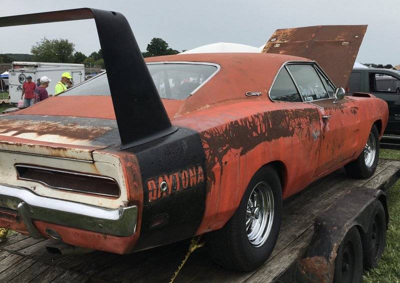

As seen today at a car show in Central New York a “bogus?” Daytona that was presented for sale as “a real Daytona” for $165k.
While it had all the Daytona specific parts on it, the VIN was XS29(see pic of radiator support vin for the rest)and it was an original AC car with the complete unit in place and AC specific firewall. No fender tag.
