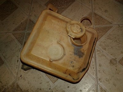

Hey Bob is that washer bottle the factory version, a dealer add-on or a generic aftermarket? I re-call the 73-74 B Body washer bottles for cars with CC looked like this (see pic).

Bob got the original and correct one for 73/74 CC cars. Can't tell about 75 and lates... maybe the one you show is for those
Strange, I've seen this type (the one in my pic) on 74 Chargers before.
Yes, that is correct according to the part number and number stamped/embossed on the bottle for 73-4 WITH Speed Control.
If you give me the number on your bottle shown, I may be able to trace it to a year/car.
Reservoir no. 3799055
Cover & cap no. 3799063
Assy. no. 3799056
Capacity 80 oz

1975-79 Coronet, Charger, Charger SE, Cordoba, (small) B body Monaco, B body Fury. Found that in my collision book.
http://www.ebay.com/itm/WINDSHIELD-...ash=item3d3c0dd339:g:DYEAAOSwtZJY--FN&vxp=mtr
Thanks Bob. Well I thought I had a small treasure there. Funny thing is that I was going to put it up for sale and list it as a 1973-74 B Body washer bottle. Now it's headed for the trash after I pull the little motor off.

Bryan, I wouldn't toss it, list it in the 75-79 section. There are plenty of Magnum/Cordoba folks looking for parts. I doubt they are being repoped. If you really are going to toss it, I can give it to the fellow in our club that has a 77 Charger.
I had a line on 2 of them back when I needed one. Both are gone, well I bought one of them. The part number is 3431965.
Try that place in Washington, Collectors Auto I think.
Thanks Bob will do. I haven't tossed it yet. I was going to pull out the washer motor but looks like a PITA unless you take the top off in which I do not want to do because I will end up ruining it. I don't know why Chrysler didn't design the bottle to have the filling hole directly above where the motor sits for easy access. I might make a quickie garage made wrench to reach the plastic hex head nut. Do you know the wrench size on these motors.
