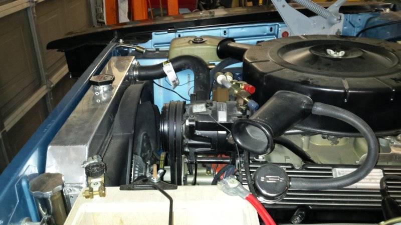

I'm using a Harrison v5 compressor which has a epr valve just like the v2 has. And the largest condenser I could find that fits. I haven't run it yet so I hope it works? I found this new compressor on ebay. Supposedly it's for a semi truck application and has mounting tabs like the sanden compressors have.
