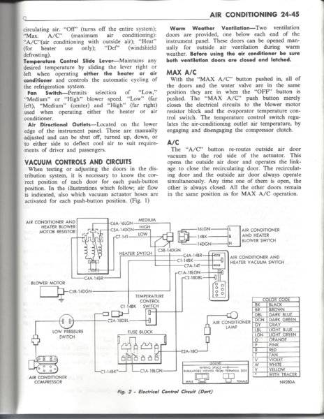

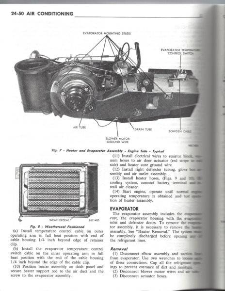

Hope these help, from 1971 FSM:
Let me know if you need more info from the factory service manual.
