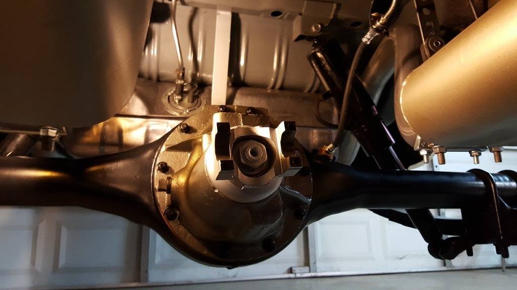

I was installing my 8 3/4 third member today. Looked up the torque specs on my phone and the first thing I see is a thread asking about the torque. "A Bodies thread, and the op states that he has broken off two studs at 45 ft. lbs. The rest join in with 35 lbs is fine or just tighten them up! One member stated that 45 lbs is too much for a 3/8" stud. FMS calls for 45 but reading that thread spooked me to use just 35 lbs. Seemed plenty tight enough to me. It's in there!
Next Question. How's this pinion play? The gears are dry, just a little WD40. No up and down or in and out play. I'm saying ok.
Again, not what I envisioned, and that's a good thing.

I get that, just tighten them and go. When you have RA like I do, the muscle to brain torque wrench doesn't always work. Useing torque specs is safer.
The back lash looks about the same as mine and I just use my 3/8 impact when I swap third members on my R/T and never have an issue.
Apply red thread lock, snug them with an impact in a "x" pattern, then torque to 35 lbs/ft in an "x" pattern. If their still the original studs they have been stretched the first time they were torqued at the factory when new. More likely to snap at 45 Lbs/ft now.
Here we are in that parallel universe again..... Just did all my differential swap out 3rd member work this past weekend! Actually end play looks to be close to what I have.

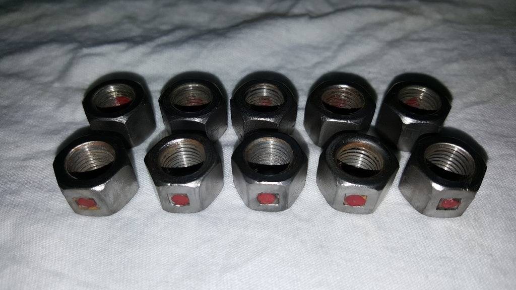

Here's an interesting find. Each nut had a plastic injection in the side. I wonder if it was done after the factory torqued them? I've seen the plastic injection done on universal joints instead of c clips but didn't know they had the technique back in '62.
I've seen the nylocks,dimpled at end,dimpled in the middle,etc but never the ones in your picture.
