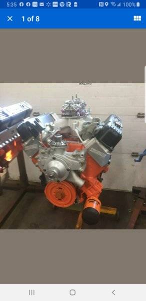

Ok so I have purchased a crate motor 440 that is built and pushing about 550hp along with a built 727 transmission with a 2800rpm stall converter now my question is what would be the best way to keep it cooled? The car already has somewhat of a beefed up cooling system due to the built 383 that was in there but I do not believe it will be suitable for the built 440 I am putting in there. The water pump on the new motor is a high flow pump so I believe that should be alright any suggestions would be great because the car is in the shop now being prepared to have all of the work done to it including 4 wheel drum to disc conversion, motor, trans, new fuel tank and more so want to figure something out soon so that I can order what I need
