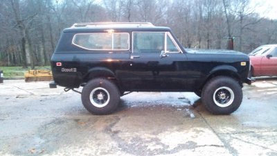

I'm working on a 1980 IH Scout, I know it's not a mopar but alot of it's parts are, including the carb. At first it bogged down for a few seconds at WOT and would slowly pick up speed. I took the carb apart, Thoroughly cleaned it, checked all of the adjustments and they were all in spec, I rebuilt it and stuck it back on and it ran the same. Then I adjusted the Idle mixture screws by the book. It idled a bit smoother but no other change. I then checked the timing and it was at 8 deg, I bumped it up to 12 deg and took it for another test drive and There was no more bog, but now it hesitates when you first get into it. It just falls on it's face for about a second and then picks up quick and goes. If I advance the timing any farther it doesn't start well. I'm fairly convinced that the issue is in the carb somewhere. Any suggestions would be greatly appreciated.

Good lookin' scout. One of my old buddies had one he painted in zebra stripes.
