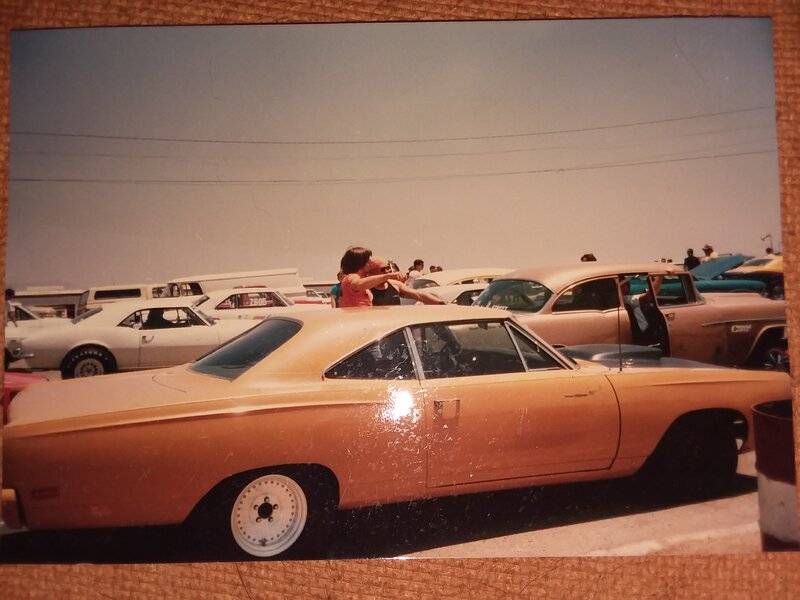

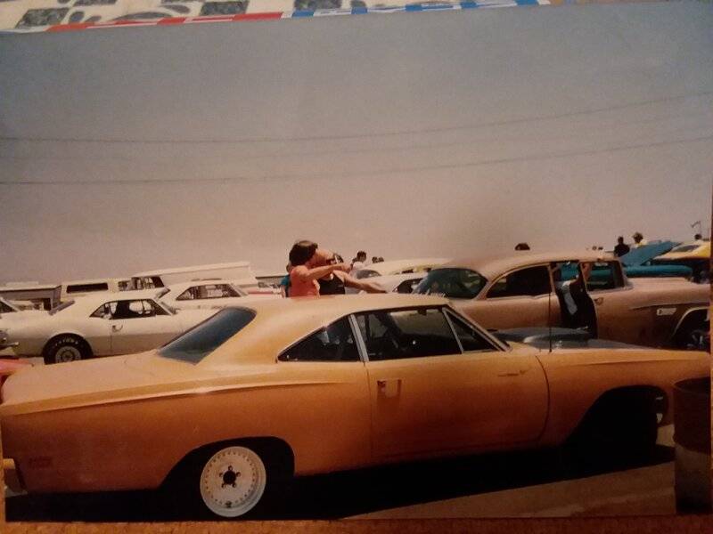

I don't have any current photos, it's buried in my back garage and blocked in by a couple other old cars I can't move yet, but.... here's a shot from the staging lanes at riverside raceway, in the eighties. Still looks the same.
I take that back. The centerlines are on my 62 savoy now, the 15x6s are back on the runner.
The girlfriend was 6' (I'm 6'3") and her dad there was a navy vet, and a Hells Angel.

So cool...
PS: Hoping to move from Kalifornia to Tennessee!
Love your car....
LOVE IT!!!
