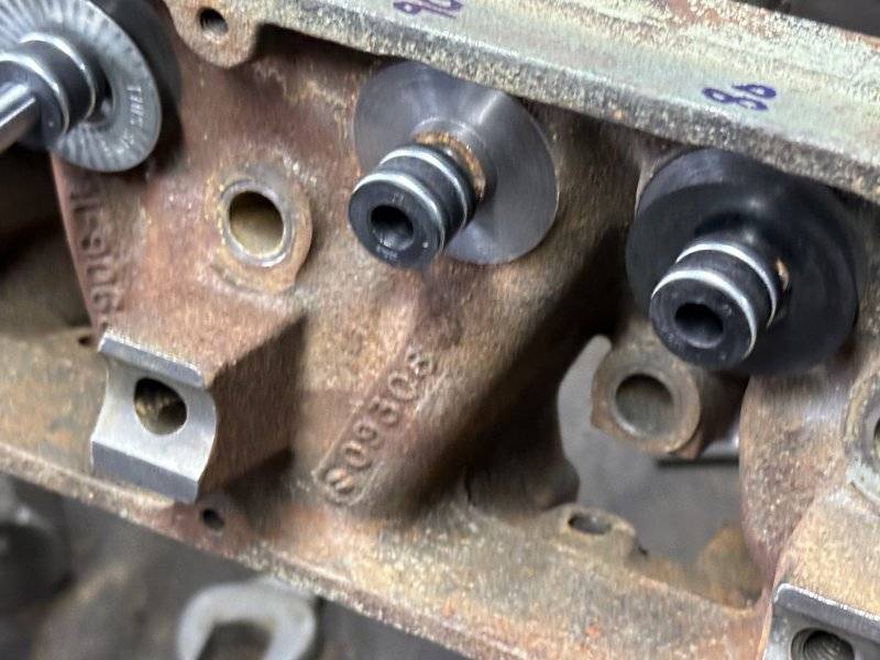

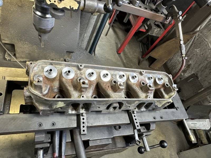

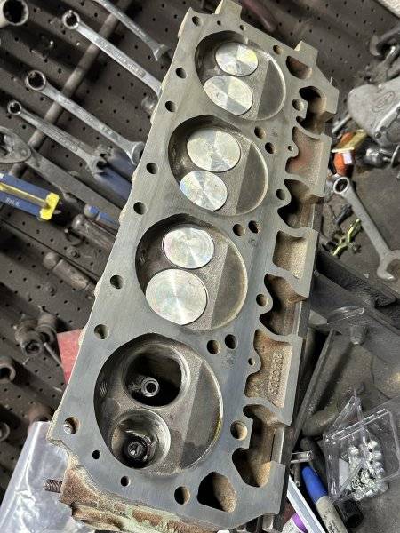

Just curious what you guys think a reworked set of 906 heads with new valves and upgrade springs are worth?
New stainless 2.14/1.81 valves and guides from machinist
Hughes 1106 springs
Bowls opened up by machinist for the bigger valves but not ported.
