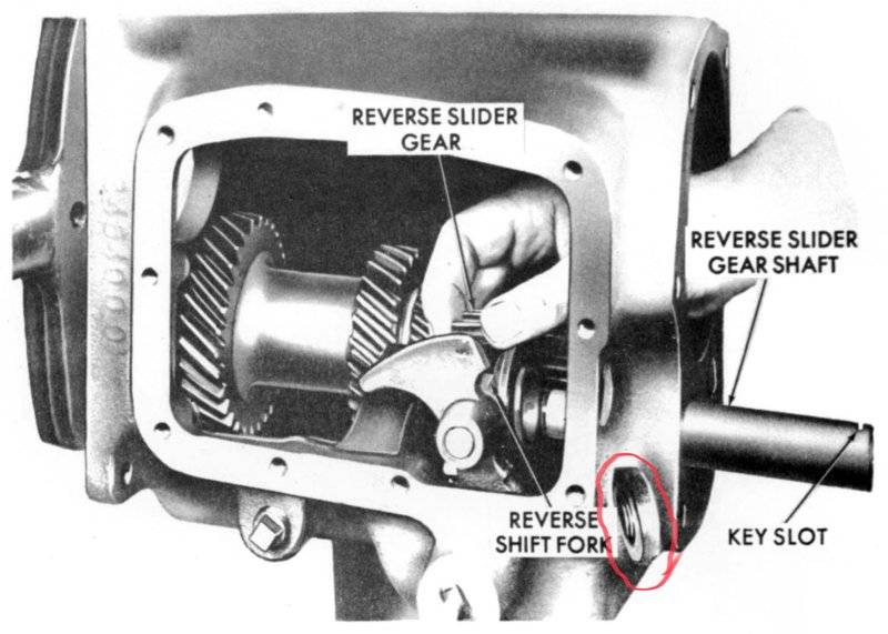

This is aggravating! I rebuilt my A833 gearbox and used all new gaskets from brewers and I filled it with oil and there’s a dang leak around the reverse detent housing to case gasket. So now drain all the oil back out to remove the sucker and try to figure out how to be certain it’s sealed this time. I used the gasket that brewers sent for it not sure why it’s leaking the mating surfaces looked smooth with no gouges or scratches.

The side cover isn’t leaking nor is any other gaskets just the detent ball and spring holder gasket the detent spring retainer bolt isn’t leaking either Just the holder where it screws into the case.
Something is not right about this picture. The reverse fork in the A833 doesn't go threw the cover plate. It goes threw the case below the reverse shift fork callout. You have circled the reverse switch location and then said it was not leaking. If I remember correctly the reverse shaft has a case cut recessed slot cut for an O ring seal. But it has been many years without taking one apart.
That is not the reverse switch location that is the reverse detent ball and spring assembly hole the reverse switch is above that hole. The flat on the reverse lockout lever at the thumb in the pic is what contacts the reverse switch the hole for it is circled in yellow.
That is not the reverse switch location that is the reverse detent ball and spring assembly hole the reverse switch is above that hole. The flat on the reverse lockout lever at the thumb in the pic is what contacts the reverse switch the hole for it is circled in yellow.View attachment 1309444
