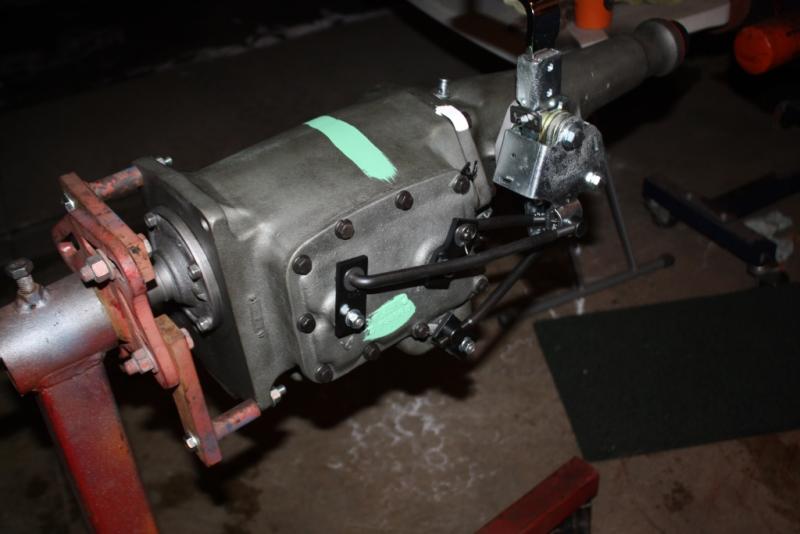

I recently changed the transmission on a 1968 coronet 383, from a '68 date code a833 to another '68 a833. The "old" transmission was a crashbox, and because it was always rammed into gear, I believe this hid the issues im having now with the new transmission.
When I took appart the linkage, I drew myself a diagram so im absolutely positive I reassembled it the same way. But im not sure it was ever right to begin with. Im not even sure its the correct parts because they look different than the ones i see in pictures.
The shifter is a hurst competition or hurst super shifter. I forget, but its an H pattern with R lockout.
I can't seem to get all the gears "banging them" its like 3rd is a mile away, and i hit another gate that does nothing (think W pattern shifter)
I've already solved one issue with the linkage, the r lever was on backward. Wouldn't allow 2/4 to engage. Also, the transmission wouldn't engage into R fully, and 2nd ground the first time I shifted too it then would act fine. This turned out to be the shift rod in the wrong hole, (farther hole, less throw) so that issue is fixed too.

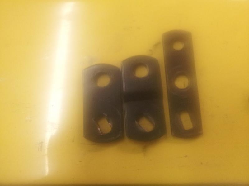

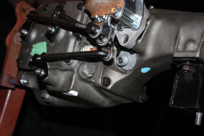

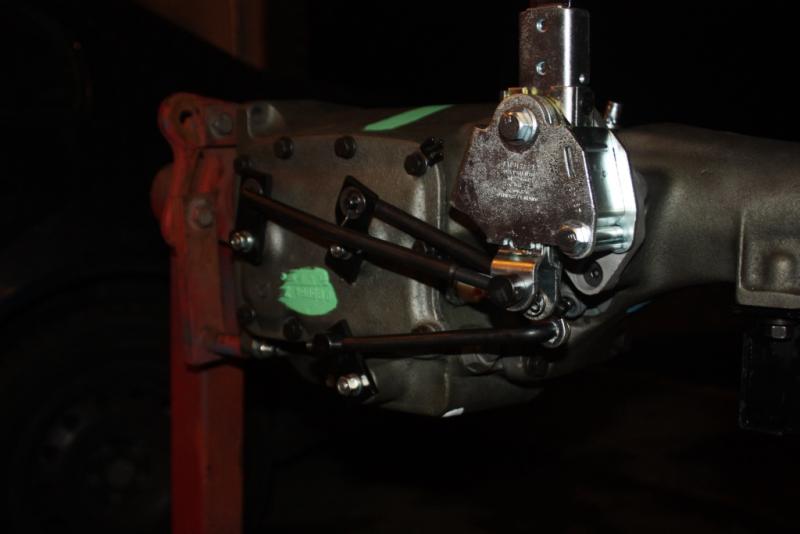

Clearly my linkages/tabs are messed up but i dont know what goes where or if I have the right tabs at all. If you look at the picture you can see that the 1-2 tab is longer than the 3 -4 tab, in terms of center to center of the holes causing a longer throw. The following numbers are pinstamped onto the parts
1054828 (straight)
1054828 (bent)
1050053 (reverse 3 hole tab)
I see I listed the same number twice unsure on my mistake on that but i remember one of them ending in a 9, that number i do not have (car garage far away) I should add the trans shifts fine for just cruising around
And ive adjusted the shifter with the pin in it twice
