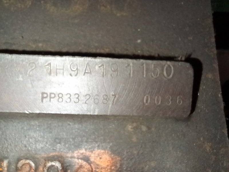

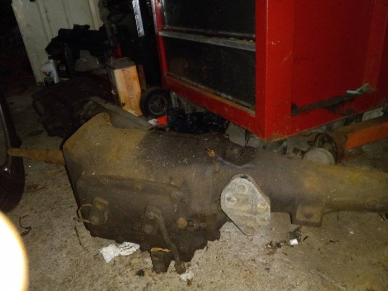

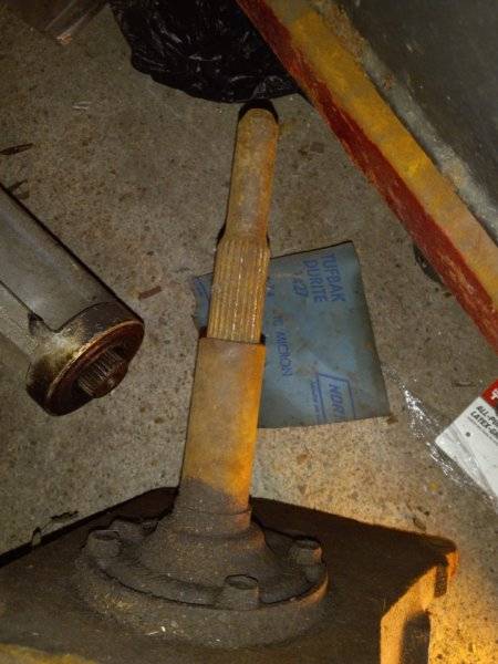

I'm right there with you about not knowing much about transmissions. I'm in the process of mating a TKO-600 5-speed to a 383, but prior to that I acquired the correct A833 4-speed trans, bell housing, flywheel, etc., and the bell housing & flywheel were both for an 11" clutch. Again, I can not confirm my comments since I'm going by what I was told before I purchased the used 4-speed setup. So I'm saying make sure you have an 11" bell & flywheel, I think you can use your old clutch fork & z-bar if it's a 10.5" clutch, which you probably have now from the Duster. I've attached pics of the A833 4-speed I purchased, maybe they'll help you in some way. Good luck!

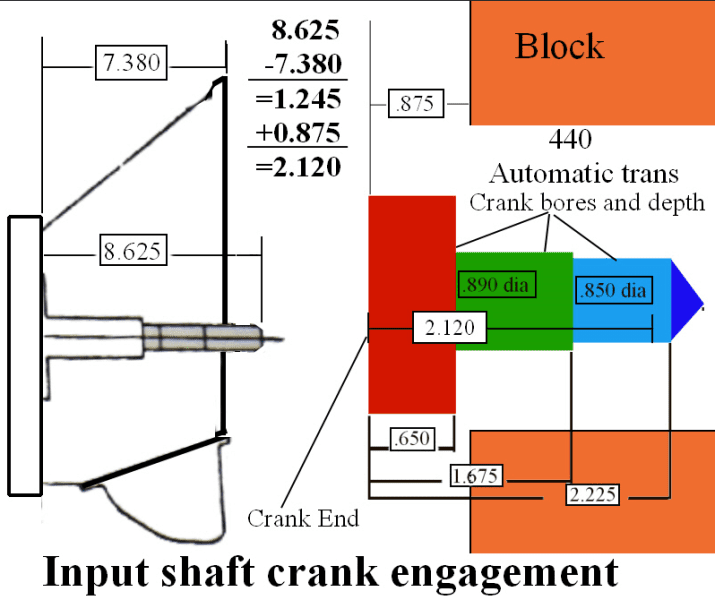

Some are drilled to depth, some just have a center. Some that are drilled may not have the stock bushing OD diameter like this 440 auto crank I measured. (green)
