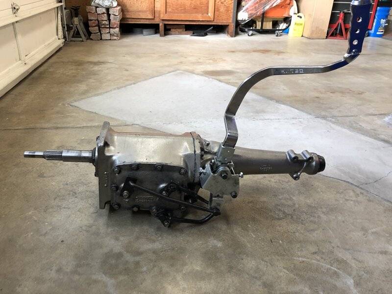

This is my factory '68 trans with factory linkage.
Trans is in neutral.

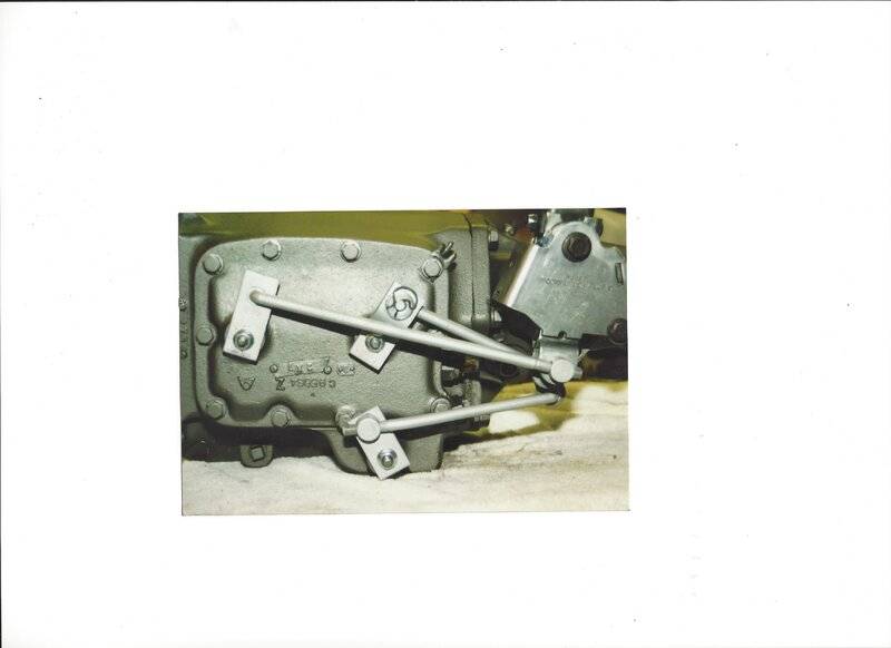

Maybe this might help.
Thanks for the photo….I may have the shorter rods reversed….3/4 rod is correct….I had it working great with my tranny out …..
