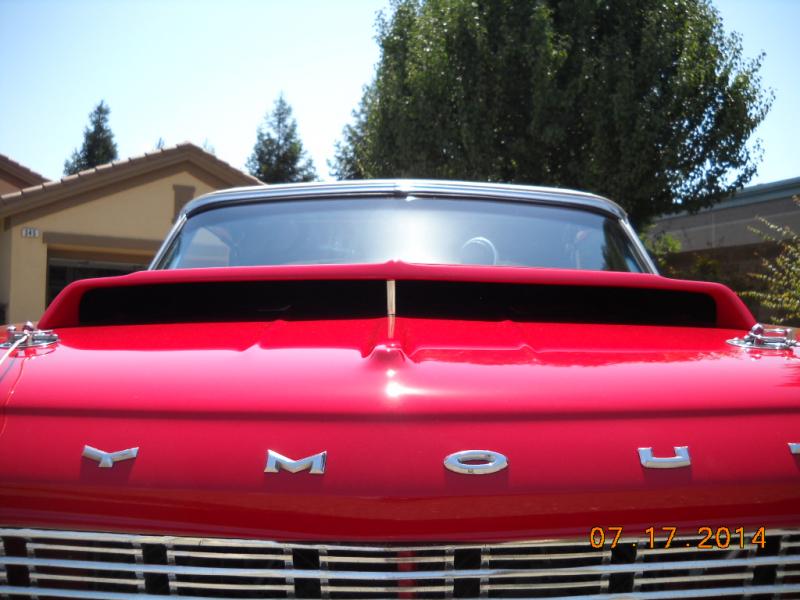

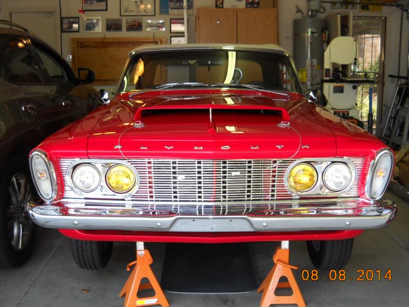

AAR RO/WO Scoop is installed
I used a 3/8" diameter piece of polished stainless, drilled and tapped at both ends for 1/4"X20 bolts. Epoxied a 3" X 1/2" piece of aluminum strap on top of the opening lip to reinforce it. Short bolts with star washers from top and bottom.

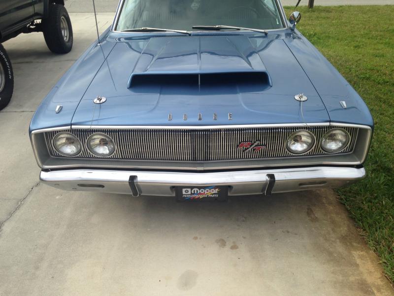

Same Principal as Coloradodave but mine is a nut bolt setup with the bolt running up from the bottom of the hood to a nut on the scoop side and price of polished aluminum pipeimage.jpg
Same Principal as Coloradodave but mine is a nut bolt setup with the bolt running up from the bottom of the hood to a nut on the scoop side and price of polished aluminum pipeView attachment 247665

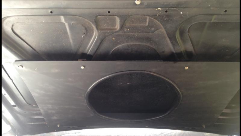

do you have pics of the underneath? I'm installing a scoop in the next couple of weeks and would love to see what people are doing with the cut out.
I don't have picture presently but what I did originally I cut out a big square hole then I got a thin piece of aluminum sheet and I put a couple crisscross bends in it with a break to make it rigid and I cut out the center for the air cleaner to slide up into I'll try to get one today

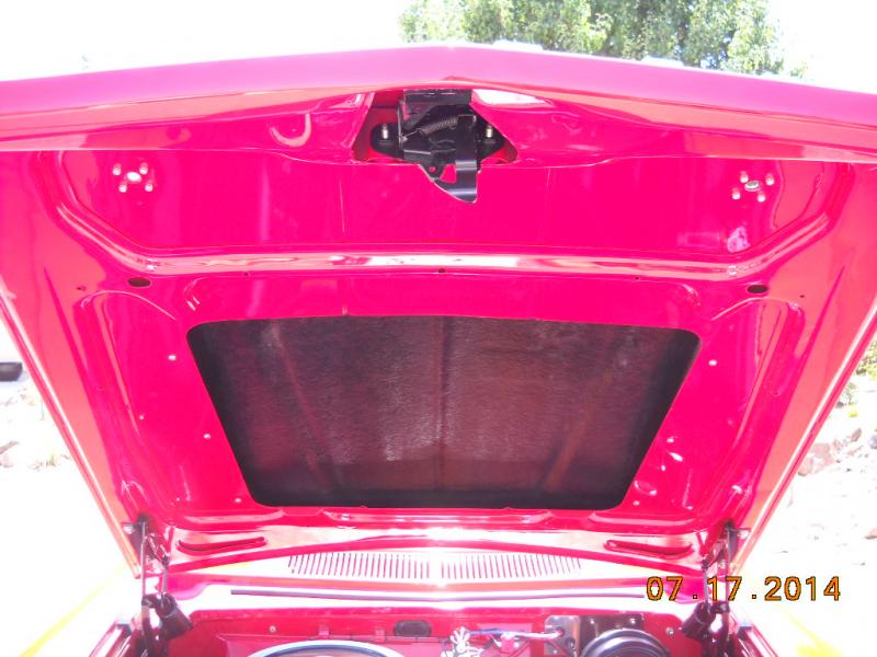

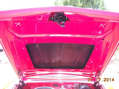

Bigal75 here are some pictures of the underside of the hood still not completely done have some painting to do and install hood insulation also

If you're asking me the question the bolt was 1/4" and it slid in the pipe Nice not sloppy And the OD of the aluminum pipe is a 5/16 and I use stainless steel washers on both sides of the scoop and on top of the hood been up to 100 miles an hour with no problems my scoop came from Kramer industries
