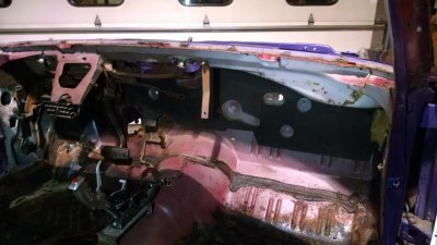

I'm converting a 68 charger non ac car to ac with all factory parts,I have the car torn down to the firewall,no dash ,no heaterbox or motor in car.Im trying to find the dimensions of the holes I need to cut in the firewall for the evap core and blower motor,im pretty sure this has been done before without replacing the firewall with a new piece ,or grafting in a piece from a donor car.if anyone has any suggestions or info I would greatly appreciate it

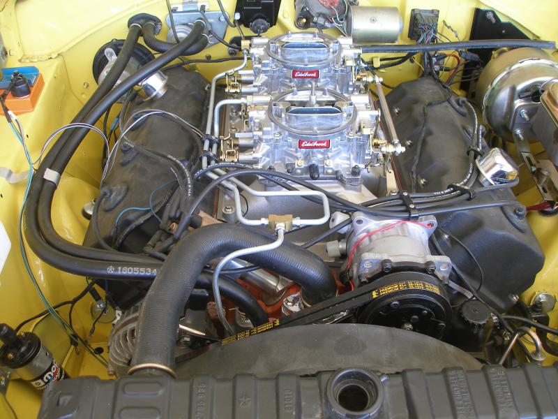

sorry forgot to mention I'm using a sanden compressor,and all new components up front,but the inside of the car I want all factory parts,so I just need to find the dimensions to cut my firewall so the factory ac/heater box will fit,just like the setup super- bee_ ski is using.
I have done what you are doing. I got a firewall section from a donor car and laid it over the existing firewall to mark out where to make the cuts. I was more comfortable doing this than trying the measure and mark method. If you do it this way you will have a couple extra holes from the insulation pad retaining studs.
I guess that's what I'm going to have to do.thanks mark b.you still don't have that firewall section do you?

well I ended up putting a fire wall in the car to get the result I was looking for.thanks for all the suggestions
