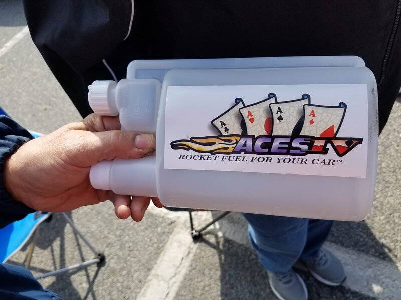

I was at OC Maryland cruise and discussed running higher comp. ,a guy swore by this stuff anybody else have any experiences with it?

The OP just asked a question if anyone has tried the product in the photo. He is not telling anyone to buy it. For some reason you're taking his post as a personal insult. It's not. Take a deep breath.

Yes. I have ran it in my Charger. Took the ping right out. It's the factory 10:1 pistons, which are really closer to 9:1 with an uncut block. The blown 392 guy is Lew, he's running over 15 lb boost in that and a short fill block. Aces IV works. Not cheap.
Oh, the guy at BND Automotive is a Mopar guy. http://bndautomotive.com/aces-formulas/aces-iv-gasoline-formula/
Thanks that's what i was asking for some one who had actual experience thank you !
The reason I was asking I have a 413 with 11.5 -1 comp. I bought it awhile ago and needs rebuilt. Pistons are fine so i was just wondering if it would enable me to run it without ruining it ,otherwise i will have to buy new pistons from Hughes i gave them bore specs said they have them. Waiting for price. I've never had eng. with this high comp. almost out of pure orneriness I'd like to put together, l know it won't run on pump gas.
If those old 413 dome pistons have a solid dome (they probably do) you can mill as much as you want of the dome off, to get the compression you want. Calculator time. You might not even need to rebalance.
Another option is mixing gas. Best pump premium + Low Lead 100 aviation fuel from the local airport 1 gal LL to 2 gal premium or up to 1:1. Maybe right for you?
