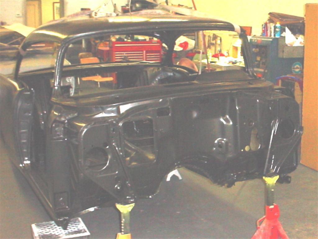

close
that looks like a 55 chevy.​
Close.... it's a 57.
A pro touring project for a customer. Just returned from the acid stripper and e-coated. Posted as an example of acid stripping.​
stripping.
