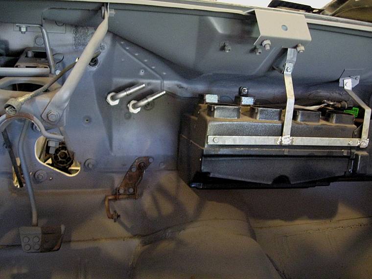

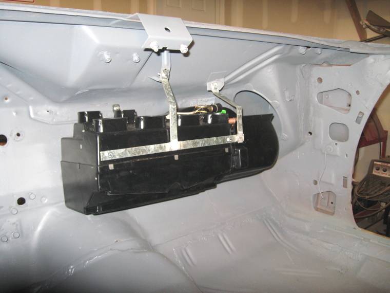

This is a Vintage Air Gen II Heat, AC, Defrost unit mounted in my '64 Polara. Just remove the old heater box, and this unit handles everything with no vacuum lines needed. Its a universal unit so it took a little thought on the mountings but as you can see, it wasn't difficult. The only thing you need to do is block off the fresh air duct with a piece of sheet metal to keep the hot outside air from just pouring in. (I haven't done this yet in this pic because I'll be running the AC lines through there as part of a hidden installation.)
Remember AC units work by removing the heat from the air... they don't "cool". So by keeping hot outside air out it will cool much more efficiently.

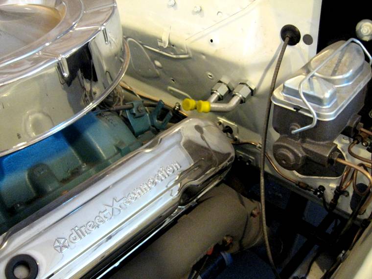

I'm running the heater hoses through the stock location (on the driver's side) so it appears as original. The AC compressor is mounted low on the driver's side where the PS pump would normally be. This is a stock manual steering car.
The heater lines will run across the top of the box and connect at the passenger's side. I'll use a couple brass 90* bends on each one to make the turn.
