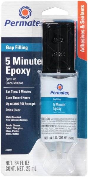

Any two part epoxy should work. They have different working times.
(A little secret when you make a mistake or spelling error, you can use the "Edit" button at the bottom of your post.)
I suggest you use an epoxy that is designed for plastic. Their "part B" has a mercaptan in it (smells like rotten eggs) and this type is usually only available as "fast set" 60 second or 5 min. dry time stuff.

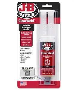

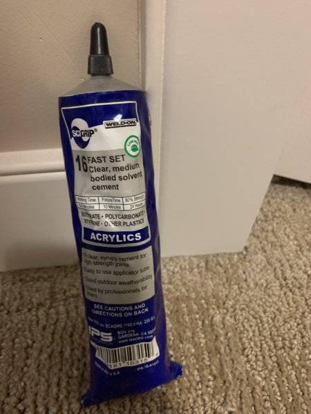

Here. Top made plastics that provide glues for everything.
I use this as it is for even glueing plexiglass together for shelving , it is a quick drying but if used right. It works well.
I used this on mine and it worked very well. .
