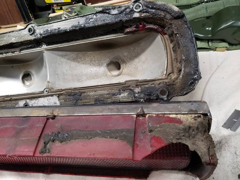

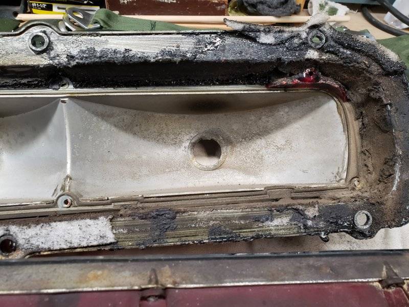

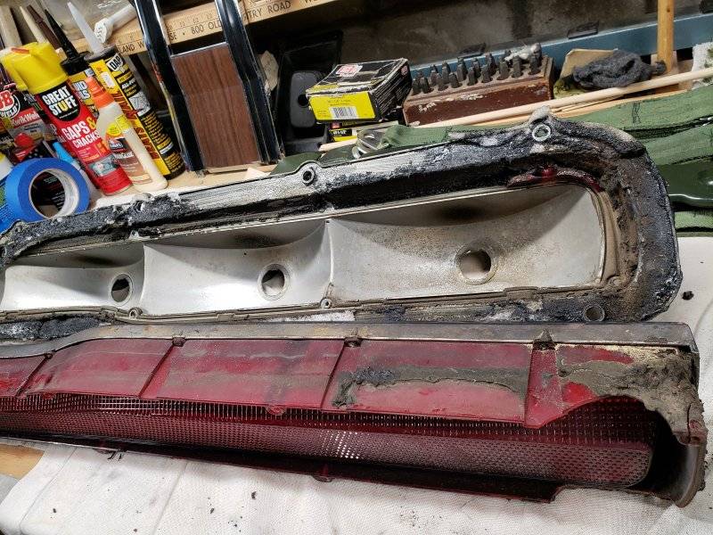

Outer front turn signal lens for the Cuda has black RTV silicone stuck on it. Some idiot used RTV to glue the inner lens to the outer lens because one screw was broken off.
How can I remove all of it without damaging the clear plastic lens?

WD40 works well dissolving the RTV, and won't melt the plastic.
If it' cloudy/scratched afterward if you have a buffing wheel try that with white or red compound. Go easy at first.

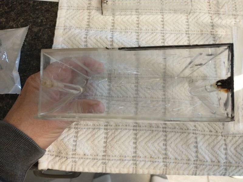

I bought Kingsford odorless charcoal lighter fluid and soaked the dried silicone for 2 hours. That was enough to soften it so I could use a plastic scraper and a brass bristle brush to remove most of the silicone. I used a red shop rag and rubbed the stubborn spots away.
I used a 3M headlight restoration kit to polish the lenses.
