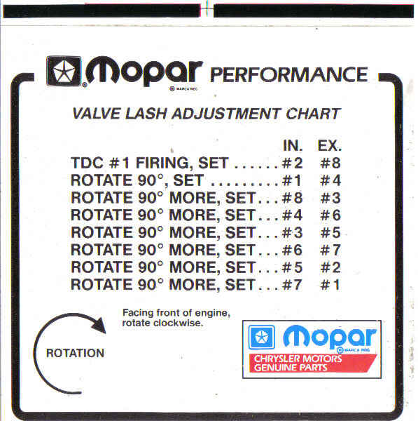

Lifter does have a spring loaded plunger that contacts the pushrod. With lifter on base circle of lobe, adjust rocker until pushrod just begins to move plunger down (compressing the spring) and give it 1 more turn and that's where you lock it. I have the chart in a MP book with the cyl/valve order in which you do them when you turn the crank in 90 deg increments. I'll post it tmrw...

Here's the chart -
