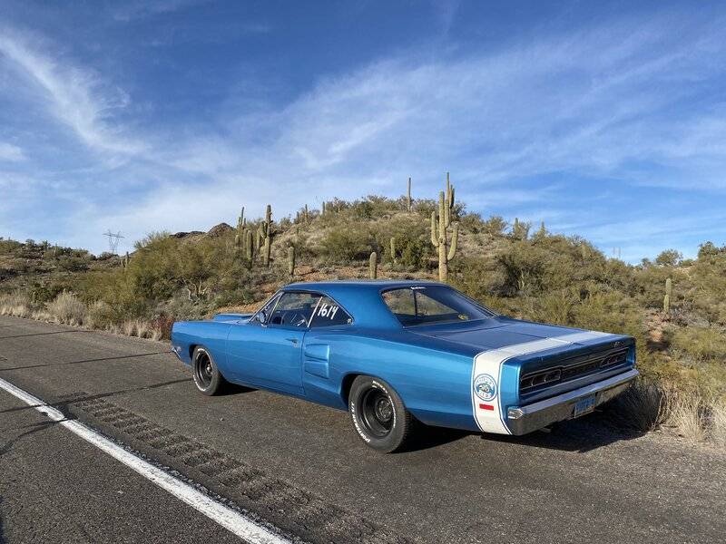

Last year, I drove to the Road Kill Zip Tie drags in Tucson with my 69" Bee. Lower Compression 440 with 3:23 gears. We cruised along nicely around 70 mph and averaged 11-12mpgs. I was able to fill with 87 octane the entire trip, never worried about over heating, and ran in the 14's at Tucson. Total miles on that trip was over 1800. Things I thought about during my drive were how I wish I had an overdrive, or had switched the rear pumpkin to a 2.76, and I would have liked to pick up the pace and average 80mph. Overall I can't say enough how great it was to really put some miles on the Bee. Road trips out weigh drag strips 100%

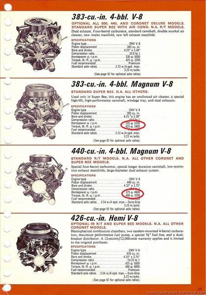

Not sure just exactly what your "definition" of a torque monster is, but for comparison, here's some numbers.
This is for '69 engines only, for a '72 440 there are no hp/torque numbers shown, although the compression ratio of the '72 440 is only 8.2 to 1. This is compared to the 10.0 to 1 of the '69 383 engine.
Also, torque is listed at 435 lb/ft for the 383 and 480 lb/ft for the 440 engine. Again, these are both '69 engine specs, no info for the '72 version.
So, comparing the torque of the '69 models only (and I suspect the '72 440 torque to be much lower due to lower compression ratio) if you take the 435 and divide by 480 you'll see that the 440 has only 11% more torque than the 383.
Probably even less when considering a '72 model 440 versus a '69 model 383
The 383 is 425 torque, not 435. So the 440 has 55 ft lbs more torque.
Your Only 11% math doesn’t add up now.
So If the 383 is a torque monster, what is a 440 then? LOL

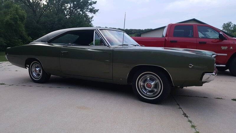

I have both a 68 383 magnum charger built to the Roadrunner 335 HP,with the 3:23 ratio, and a standard 69 Coronet 383 with the 2:76, .
the charger is an original 10.0 compression engine, and the coronet is a 9.0 compression engine.
other than that, both engines were rebuilt the same, with the Magnum cam, dual exhaust, carb, etc.
The charger has the personality of the HP engine,crisp from the light and aggressively accelerates more quickly. at 70 it is right at home, but would be happy to go 100.
the Coronet is a bit more mild due to the lower compression, and taller gears. but at 80 mph and up the Coronet really comes on and makes it look easy.
For travelling I had both the 440 and 383, , and the 383 loved the mountains and got better mileage, and ran cooler all the time.The 440 was a 71 new Yorker, and would get 12 mpg climbing to flagstaff at 80, and 15 on the flat. but that engine had the 383 two barrel cam that year, the 383 AVS carb, (which chrysler did that year) and 2:76 ratio.
But travelling the midwest In the charger and Coronet, I see little difference in mileage between the different cars ratios, if driving 60-70 MPH.
I do like the sound of the 10.0 engine though, the coronet sounds like a two barrel engine with the four barrel added.If I had it to do over, I would have left the torquey two barrel cam in the Coronet.
I don't think the HP cam was a good choice, with the stock stall convertor, combined with the 9.0 and 2:76 rear ratio.. That is why the Coronet is a bit slower to get going then the Charger.
2:76 ratio rears were optional on 68-69 Chargers with the 330 HP option,as I owned one in Houston in 1986. It had been submerged during hurricane Alicia, so I salvaged it. The differential from that car is presently in my 69 Coronet to this day!
I wanted to also to say that if you decided on the 440, I would duplicate the chrysler cam, Purchase a new Holley, and use the 2:76. A friend recently Installed a 68 440 Standard engine with stock stall and 2:76 in a 67 Charger. That is such a nice car, and with that application the car is an absolute torque monster at any speed.
The two have stock 14 inch rims and 225/70 tires, so nothing unusual there.
in the city the charger uses more gas, but who is counting? Lol
