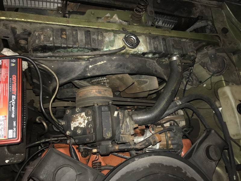

I've got my 70 Coronet R/T that I want to go cruising in and the OEM radiator finally gave up the ghost.
I Don't have $1200 for a Glen Ray radiator and would rather just buy an aluminum radiator that can drop in and drive. My only requirements are:

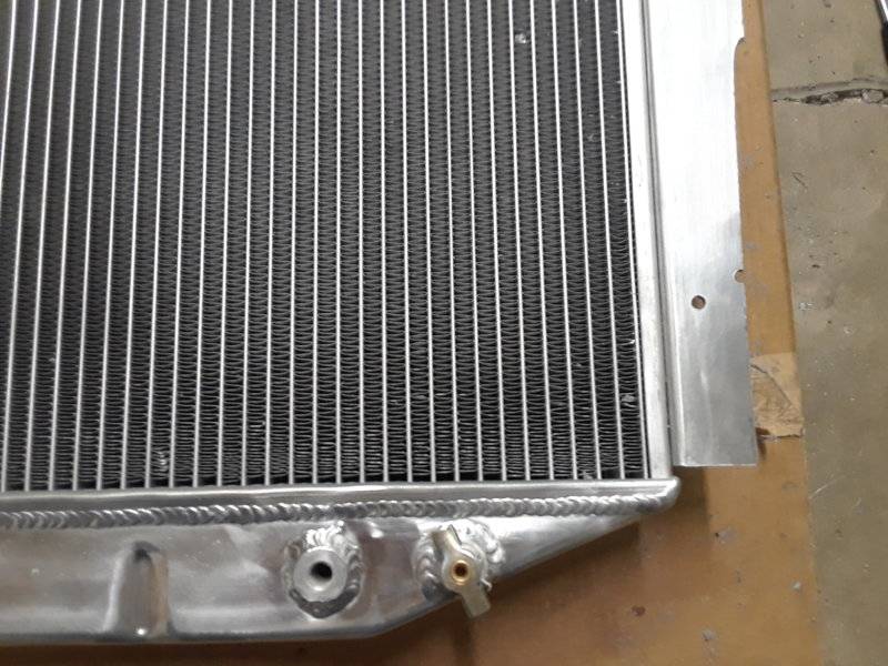

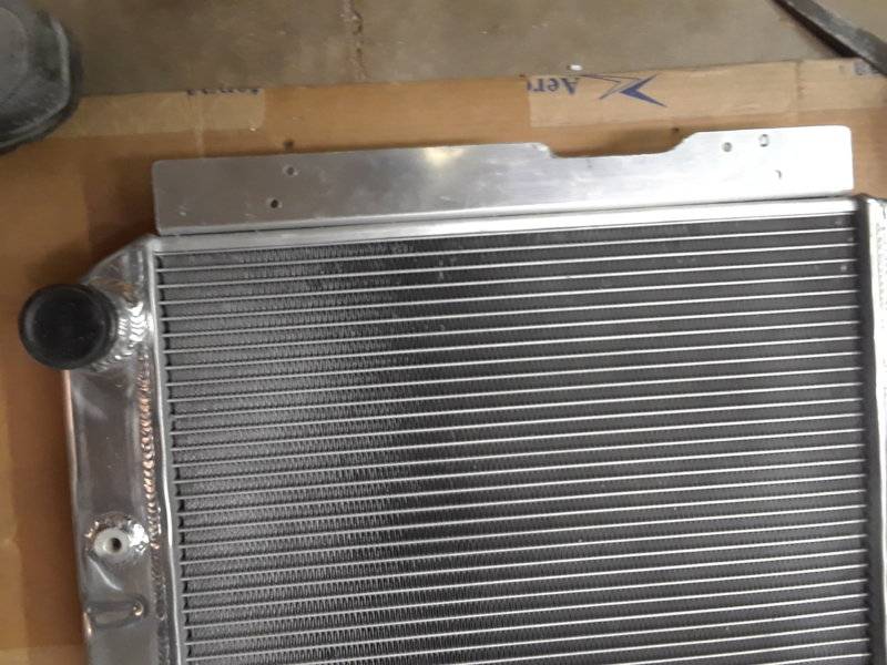

Contrary to what I was told, quite a bit of fab work was required for fitment. I know there are lots of people on FBBO that says different, but that was not my case.
Then about a month of ownership and it started leaking at the upper hose neck. ECP does not cover return shipping which would be $60. I had a local diesel participants filter rebuilder reweld the neck.
Cold Case for me from now on out.
Needed to drill shroud holes also.
More fab work
drilling holes for the fan shroud is a given for an aluminum radiator.....looks like I'll be ordering my Cold Case rad tomorrow.

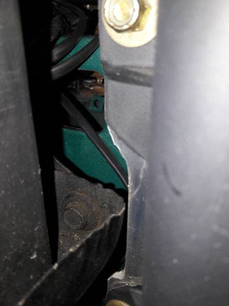

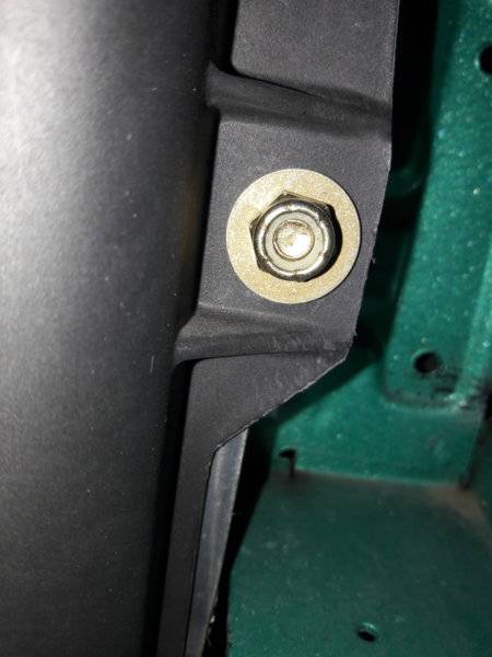

I had to grind for fitment at the battery tray, and then down low on the passenger side to clear. One mounting hole was misdrilled and I had to elongate it more than I really wanted to, and the shroud barely fits.
