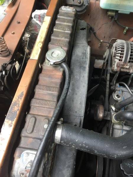

            Thanks, but niether of the those radiators will work. Mine has both outlets on the driver's side. I'll post a picture tomorrow. US Radiator is the only one I've found that makes the radiator I need.
          • Ccas
            Ccas FBBO Vendor FBBO Sponsor
            Messages:
            94
            Likes Received:
            97
            Joined:
            Dec 6, 2016
            Location:
            philadelphia, PA
            Local Time:
            1:44 PM
            26" with both on the same side? I've never seen a 26" with both on the same side. I would like to see a pic. thanks!

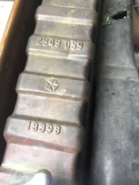

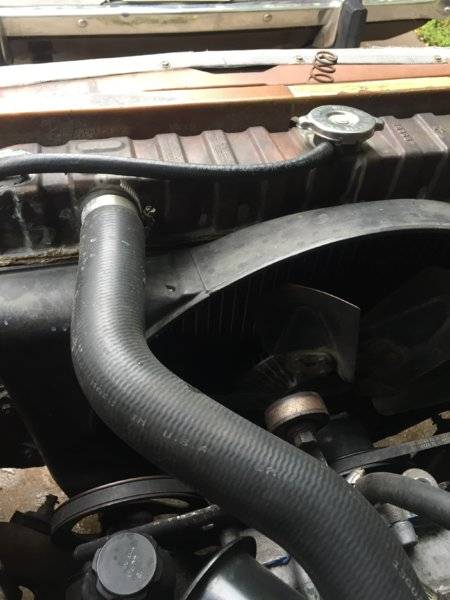

            • Thanks! Thanks! x 1
            • Aeronet
              Aeronet Well-Known Member
              Messages:
              961
              Likes Received:
              1098
              Joined:
              Nov 7, 2018
              Location:
              Wagoner, OK
              Local Time:
              12:44 PM
              If you enlarge the 2nd photo you can see the bottom hose.

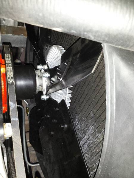

              • Mocajava
                Mocajava FBBO Gold Member FBBO Gold Member
                Messages:
                949
                Likes Received:
                426
                Joined:
                Jun 2, 2015
                Location:
                Brighton Colorado
                Local Time:
                12:44 PM
                I got a Cold Case with shroud and two electric fans for my 496, fit like a glove and keeps her at 185 degrees. Enjoyed working with them!

                  Going to order the 754K for my 540, it's going to be tight..

                  wow..... unless they've made some changes to the mounting, it's 3/8ths of an inch too narrow to line up with the OE bolts.
