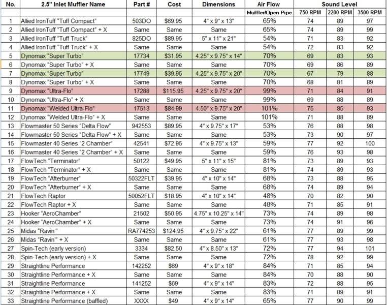

I picked the Welded Ultra Flo as shown in the chart below. I had Flowmasters on the car and did enjoy the sound for awhile. At one point I thought I'd try something different so I looked for a better flowing muffler and stumbled upon this chart.
Mine are not quiet but they are quieter than the Flowmasters at every point.
