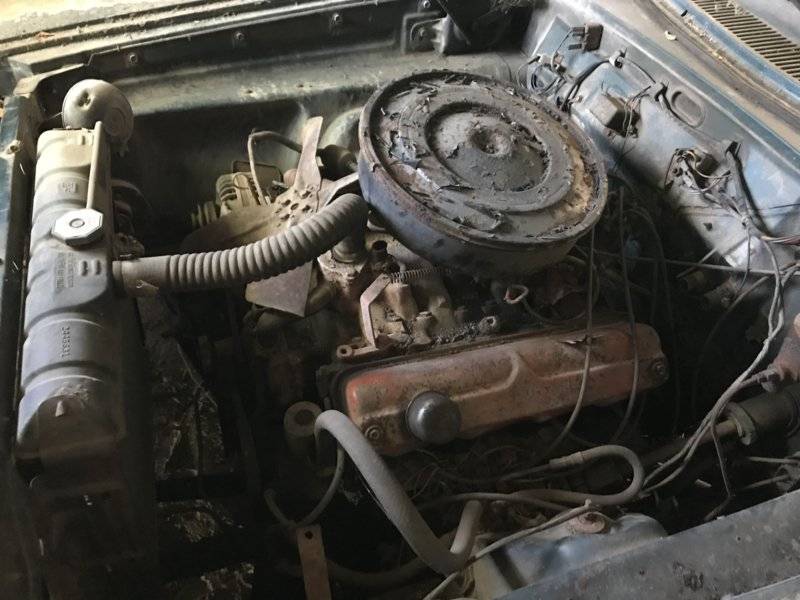

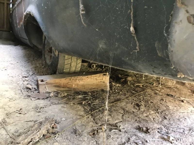

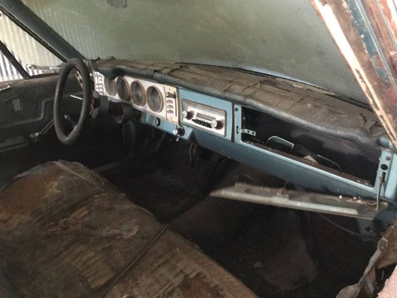

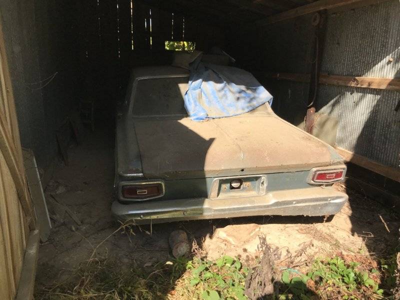

I recently purchased a ‘64 Fury convertible that came with a ‘64 Belvedere 318 4 door sedan.
I’m not going to take the entire car, but am going to pull off it what may be of use to me or others. Any suggestions?
I’m currently planning on pulling the following:

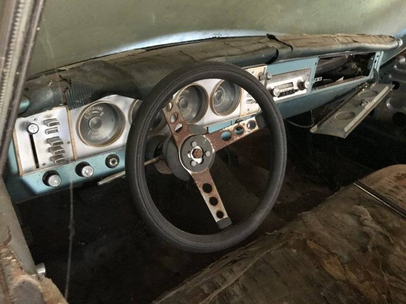

- dash assembly
- push button shifter and cables
- radio
- taillights
- grille and headlight trim
- radiator
- reverse light assembly
- horns
- voltage regulator, wiper motor, etc.

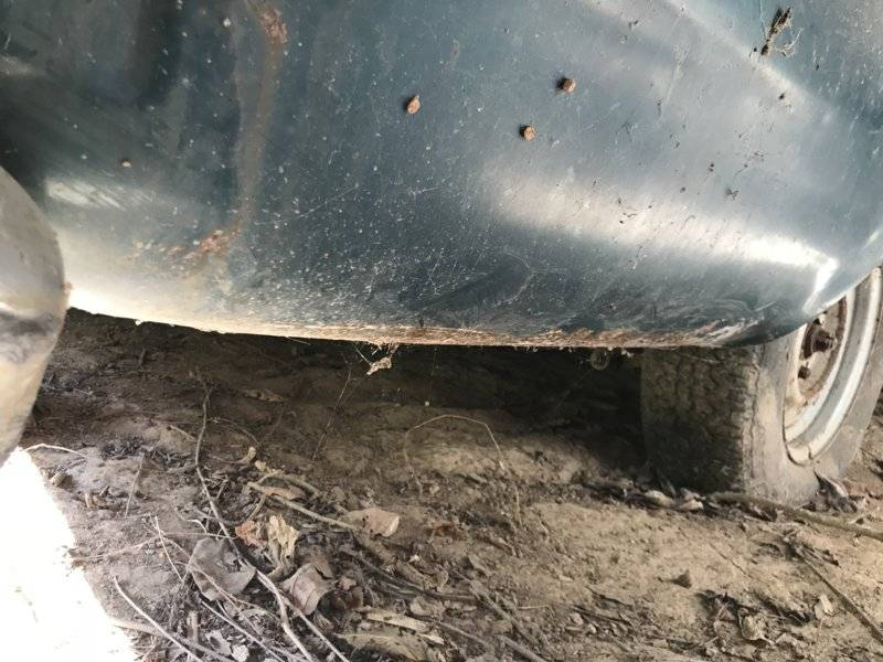

The lower quarters are really solid behind the rear wheel wells. Would these work on my Fury? If they would I’ll cut patch panels.
Would the trunk from a sedan fit a convertible?
Anything else?

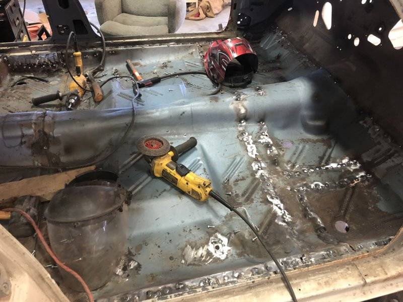

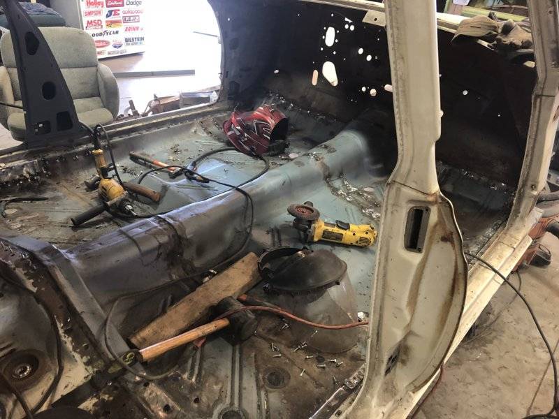

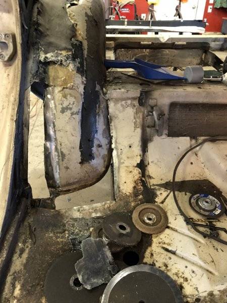

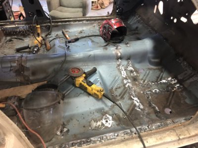

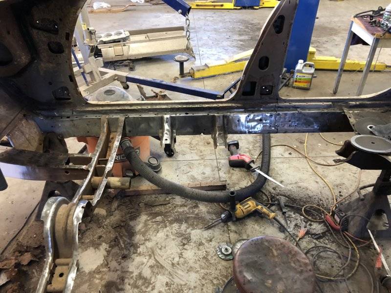

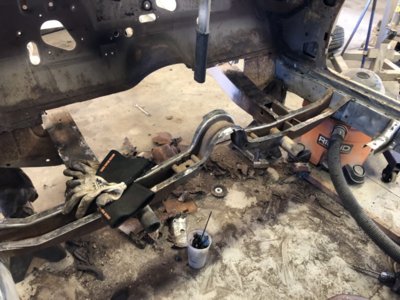

I have completely disassembled two 65 Coronet 4 doors... I /tookcut everything off the car including the rear quarters... In fact, I just installed the floors from it in my 64 Savoy wagon. I’m with the guys here. Take the entire car.
