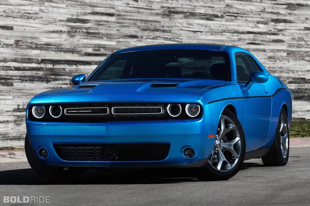

The new breed of Challengers have windows pushed out to the edge to reduce turbulence. There are foam seals between the fenders and doors. Rain gutters are built into the roof. I did read that the styling department had trouble though with the grille. They wanted that recessed headlight and grille look the 70-74 models were famous for but that design results in an air scoop much like the 68-70 Charger did. There were compromises made to push the grille forward slightly but the top 1/4 of the headlights were flattened off to give the look of eyebrows over angry eyes. I love the look. The car still is second fiddle to the same year Chargers though for tops speed due to the aero of the car!
The Wife and I bought a 2015 Challenger in this color. See what I mean about the grille and headlights?

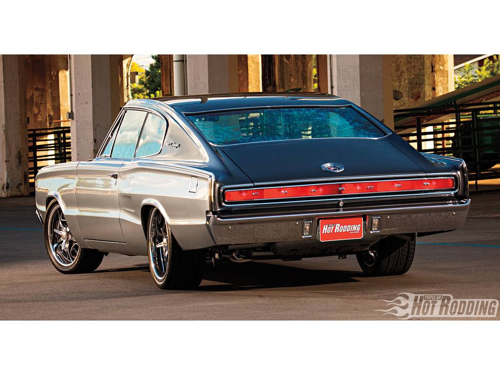

The 66/67 Charger rear half looked like an AMC Marlin from the early 60s.
The 68-70 Charger rear window looked like the 66-67 GM Chevelle.

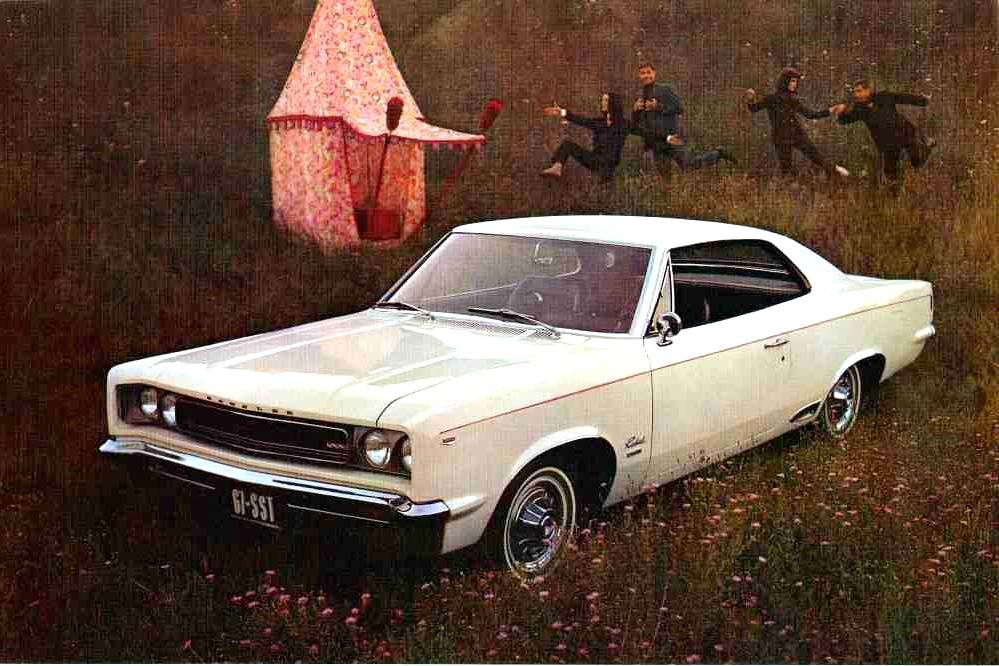

AMC Marlin.
1966 Charger...

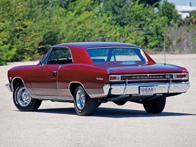

1966 Chevelle.

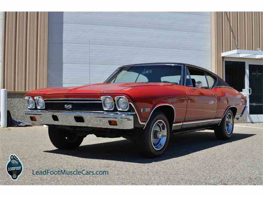

1968 Chevelle. Look at how the 66 was more flat and squared off like the 68-70 B body cars were, then GM went rounded and softer lines like the 71-74 B bodies later looked.

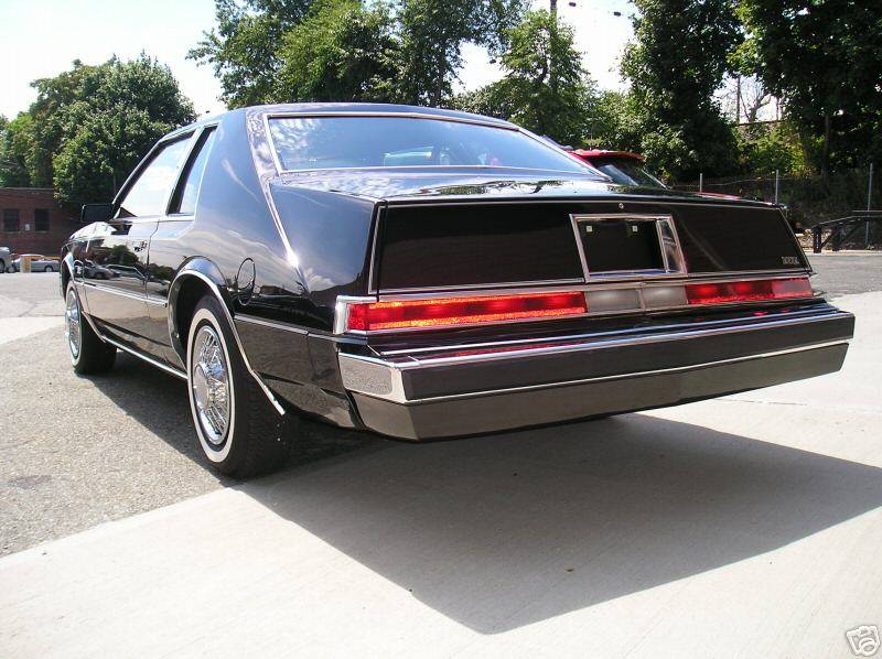

Look at the Cadillac here, the sloping ridge on the C pillar. Distinctive but also ugly!
Okay, my last "off topic" picture:
The 1983 Imperial followed that Cadillac Seville by a few years. Hey, I love the Mopars of old but Chrysler did rip off some designs!
