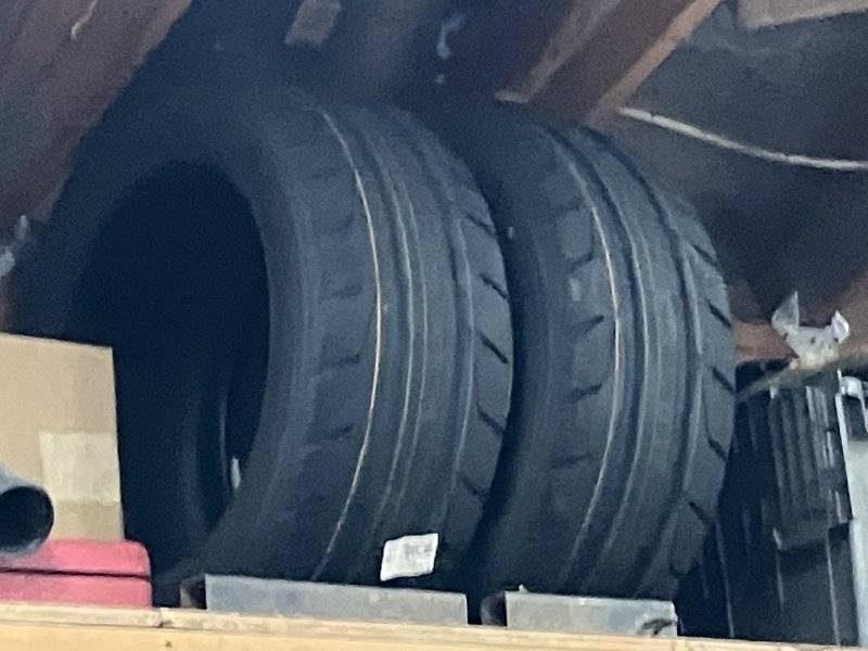

Secondly, I have tires that are sticky and wide. 100 treadwear tires do not last long and are not great for wet weather.

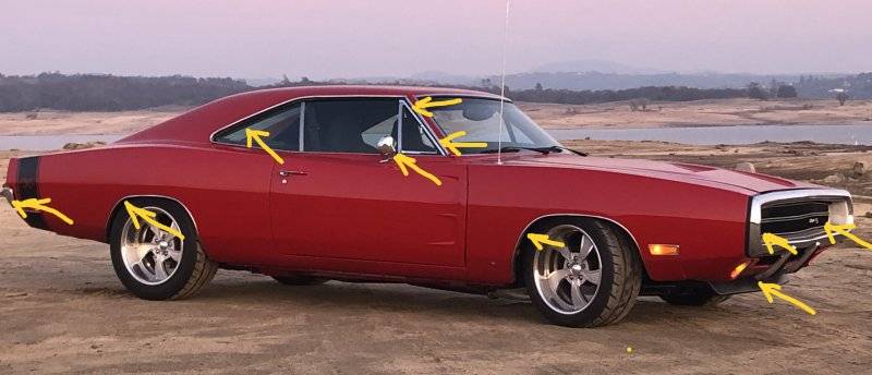

How much of the noise that we have is from the wind itself? Looking at new cars, you see hidden rain gutters, flush bumpers, wheels pushed to the edges of the body and mirrors with rounded or pointy shaped sections facing forward. For contrast, look at this:

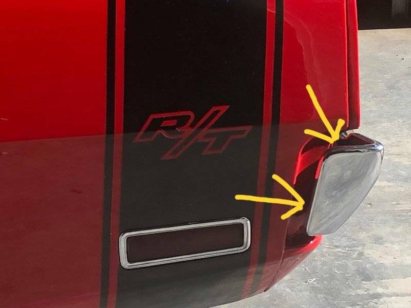

Starting from the rear, you have a bumper that has a noticeable gap from the body where air can get disturbed when flowing by.
Moving forward, there is the rear wheel opening that has a gap between the tire and body. Above that there is the quarter window taper which has a bit of a pocket in it at the bottom. The side view mirror is almost flat at the front side. Above that, the A pillar has the start of the rain gutter and the wing window. The windshield wipers certainly grab the air along with the front wheel openings but how about the huge sugar scoop grille?

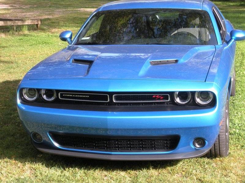

Looking at a late model, you can see a lot of differences if you look close.

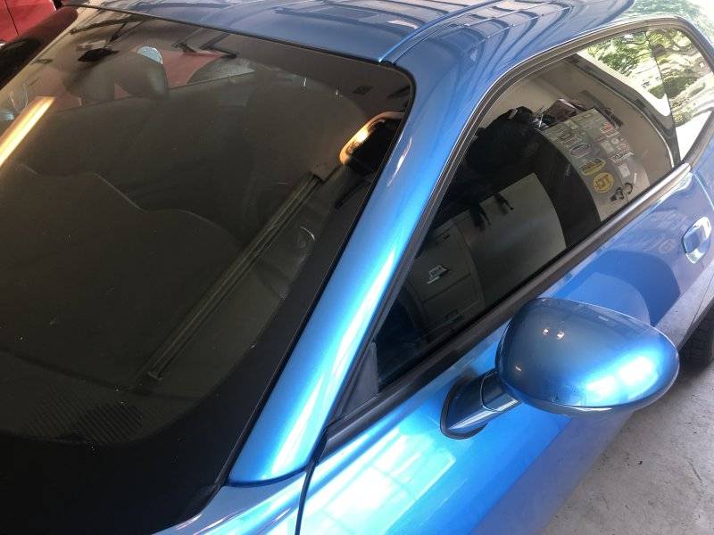

As you might expect, the recessed grille is a step backward for aerodynamics but was deemed necessary to get the styling right for this car. Still, look at the gentle shape of the front bumper, not how the tires are out to the edges. The windshield wipers are tucked down and out of the air flow. The mirrors have no flat or blunt faces either.

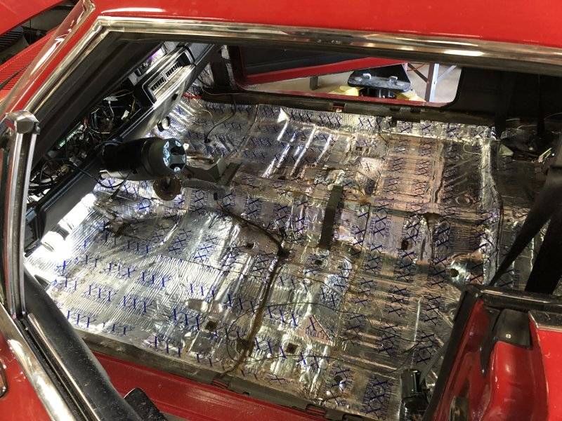

In 2012, I did add a fair amount of "Rattle Trap" matting.

The late models have flush mounted windshields. This can be replicated but now I'm looking at a custom windshield or shrinking the stock opening and fitting the stock windshield, both options are not cheap.

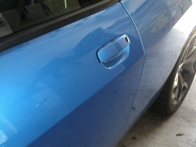

Flush door handles? Hmm...Hard to do without going custom....plus, I like the stock design.

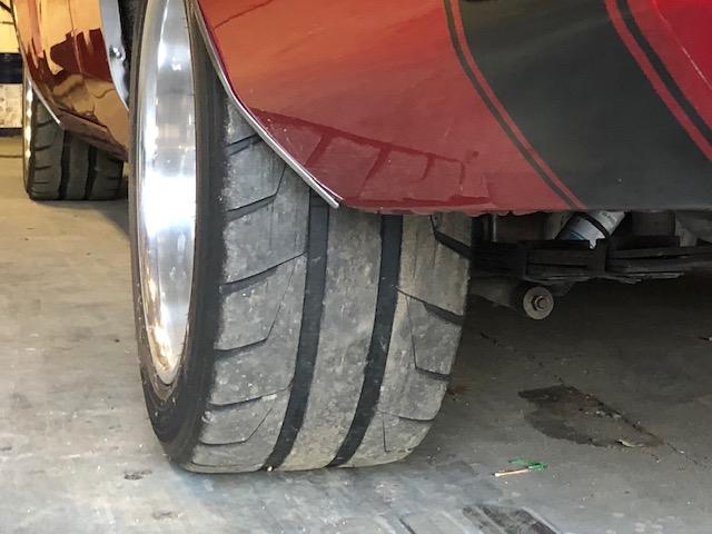

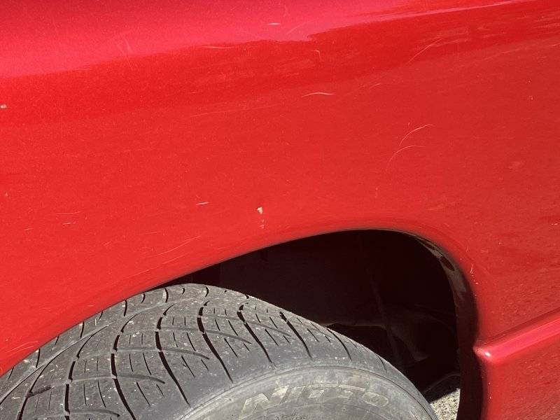

I do notice a slight difference in noise depending on the road surface but not like I notice in my truck and the Challenger. The Charger has road race type tires with no sipes or rain drainage grooves.
The tires on the truck have those small grooves.
I don't think much noise comes from my tires.

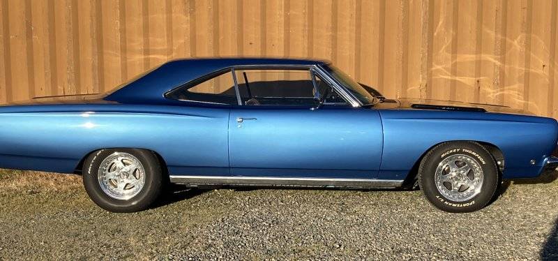

A short time ago as I was working on Dwayne's Plymouth....

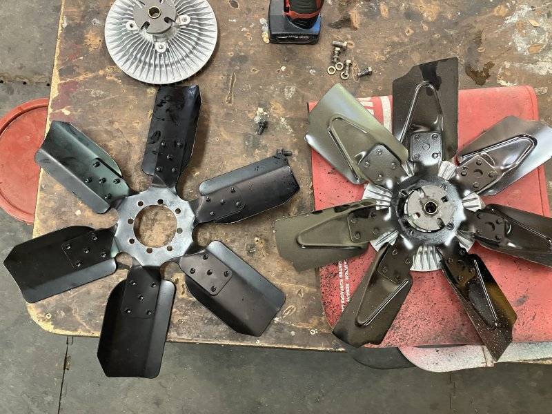

I was reminded of the noise that is generated by the engine fan....
In his car, the 7 blade fan made less noise than the 6 blade. A few factors are at play though. The shape of the blades, the angle of them and the spacing between the blades all affect the noise. The Mopar 7 blade unit is excellent at pulling in air without making too much noise. I have one in the red car and put one in Dwayne's car.
