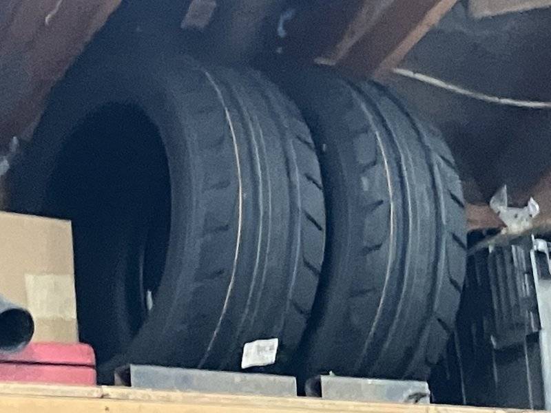

Secondly, I have tires that are sticky and wide. 100 treadwear tires do not last long and are not great for wet weather.

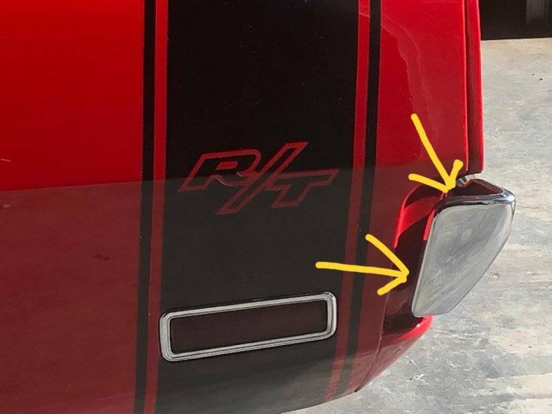

Starting from the rear, you have a bumper that has a noticeable gap from the body where air can get disturbed when flowing by.

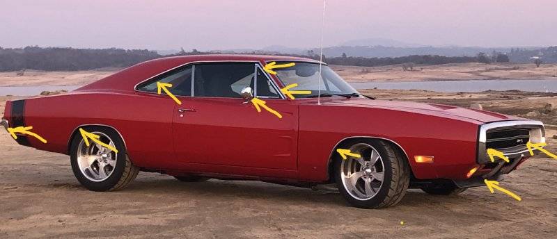

Moving forward, there is the rear wheel opening that has a gap between the tire and body. Above that there is the quarter window taper which has a bit of a pocket in it at the bottom. The side view mirror is almost flat at the front side. Above that, the A pillar has the start of the rain gutter and the wing window. The windshield wipers certainly grab the air along with the front wheel openings but how about the huge sugar scoop grille?

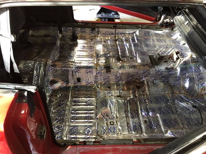

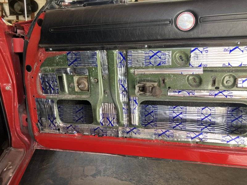

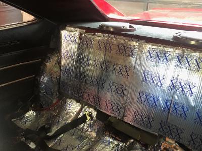

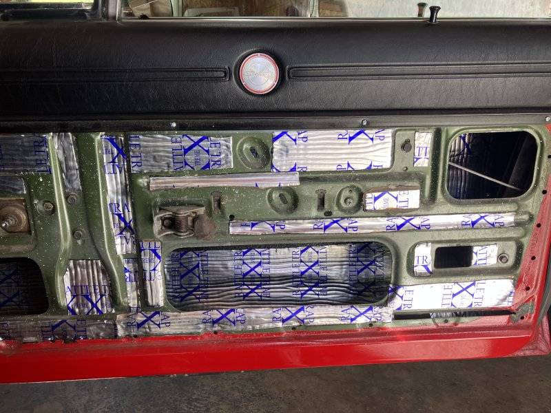

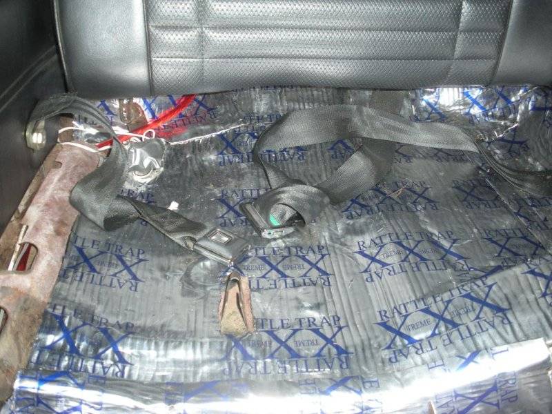

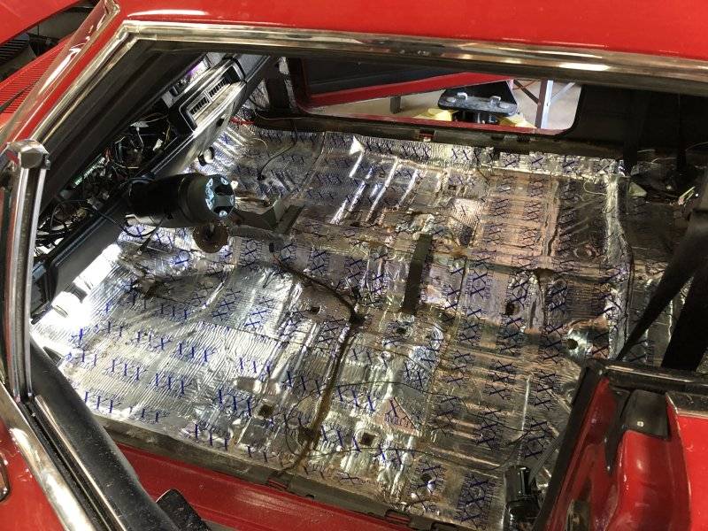

In 2012, I did add a fair amount of "Rattle Trap" matting.
