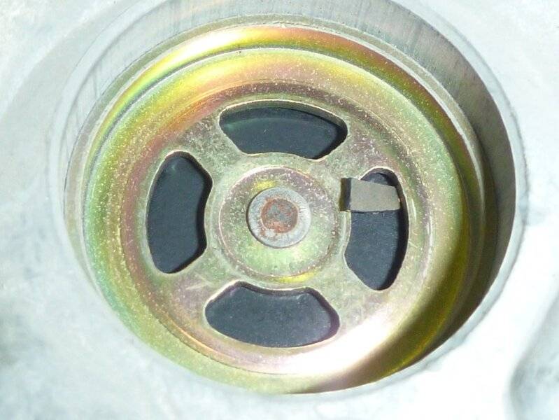

Your heat riser valve isn't stuck shut?
A valley pan with a block off might help.
Also float bowls are small and directly above the hot intake. That combination is just asking for evaporation. Worse after a hot soak and today's puppy pee gas sure doesn't help.
This one blocks off the heat riser port accross the intake.
