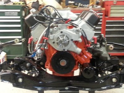

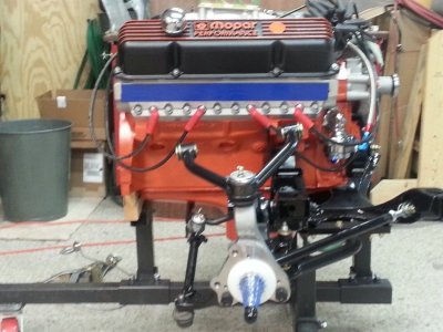

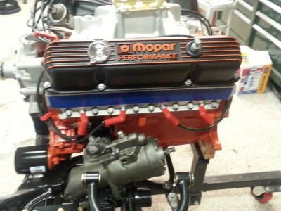

I'm not up and running yet, I'm doing a ground up. I went to Firm Feel and talked to Dick from there. With what we talked about and from what I learned, I've had nothing but positive remarks, comments on what I did. Other members can chime in as I know many have done the same. Dick at Firm Feel is a wealth of information and knows his stuff.
FYI- Items I got from them:
Upper tubular control arms, re-enforcement kit for LCA and K member, P/S gear box rebuild and upgrade, P/S pump rebuild, and bigger front sway bar, and torsion bars.
