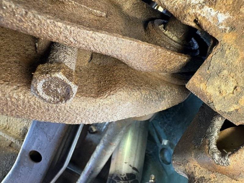

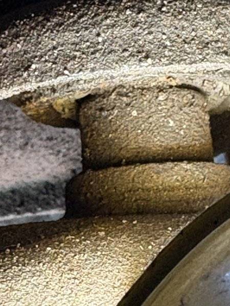

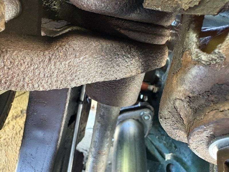

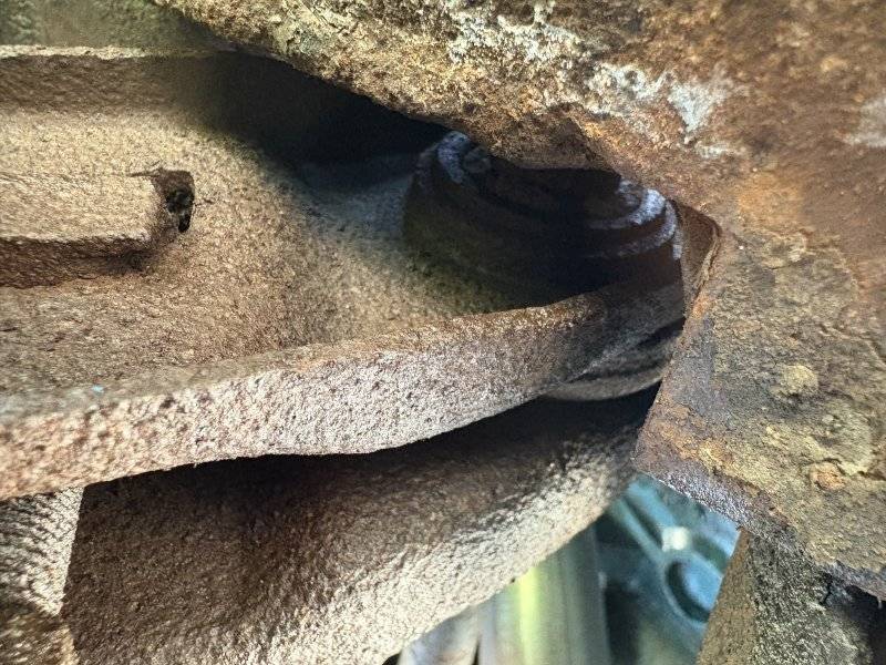

When driving my Charger I’m getting all kinds of clunking and bumping when I apply the brakes and hitting bumps. The sway bar bushings are done, but would the make all that nose?. The steering components are new and tight. I was thinking lower control arms, but I tried to make them move with a crow bar and they won’t move. Let me know if you guys need better pics.
The bushings don't look mushroomed. May not be a bad idea to r&r as a just because. The strut rod bushings will give you clunking noises as will the shocks. Shocks could have bad bushings and/or be loose. If you elect to replace the lower arm bushings, do the struts too as you have to undo them to get the arms out. While the arms are out, have a good look at the welded in sleeves, for the lower arm shafts, in the K. Look for broken welds, damaged sleeves etc. Judging by your photos, rust may be giving you issues too. If so, possible replacement time for affected components.

Yea, the cars hasn’t been registered since 1984, so it’s been sitting for years. I ordered the LCA, strut rod and sway bar bushings. The sway bar bushings are shot, that’s for sure.

Update. I finally took the time and checked out the lower control arm bushings. The passenger side was dried up as hell and the driver sided was sloppy as all hell. The pin was moving around in my hand, so that explains the thumping and the caster problem. I'm upgrading the LCA and strut rods bushings to poly.
