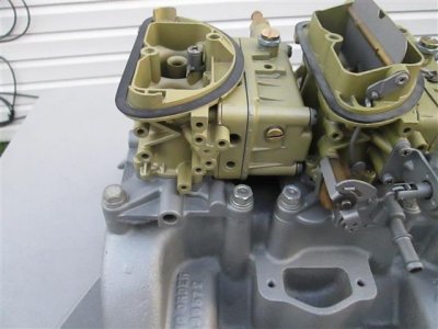

if the carbs are list # 4782 and 4783 (i think i'm correct on these numbers) use 80's in the end carbs and 64's in the center. if somebody stuck some 500cfm 2bbls on the ends then probably somewhere between 72-74's. a picture of the carbs would help.
You are correct on the carb numbers.
I need to know about the vacuum lines too. There is one vacuum source coming from the base of the center carb and two places that need (??) vacuum. The choke pull off and the piece sticking out of the center metering block. Thanks
use 80's in the end carbs and 64's in the center. pretty sure thats what they came with from the factory. the choke pull off needs a hose to connect to a nipple on the base plate. the nipple on the metering block is for the vacuum advance. i think one of the end carbs float bowls is wrong. look at the placement of the sight hole screws on both bowls.
Good catch on the sight hole ,never even noticed that. Should I set the level to that bowl or to the others? I will have to watch for a different bowl. Hopefully it goes on today. Thanks for all your help. I do appreciate it.
i haven't used those carbs in many years but i'd probably set the float level similar to the back. usually the lower sight plugs are for secondary bowls on a 4bbl carb (vacuum 6-pak carbs use a secondary bowl on the end carbs with the lower setting). i'd set the end carb level to the bottom of the sight hole and the front carb the same plus a 1/4 turn.
