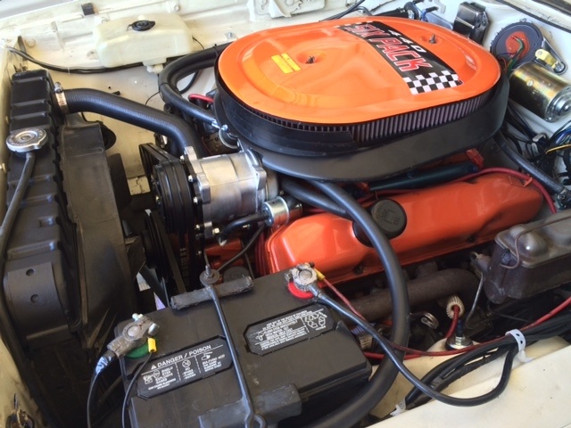

I bought the compressor upgrade kit from Classic Auto Air and installed it in my Charger last Winter. It came with a new Sanden compressor & mounting brackets, new dryer, AC thermostat, expansion valve, AC hoses and misc hardware. I kept my original evaporator and condenser, but did blow some laquer thinner through them to clean them out. I like the system and it wasn't all that expensive.
Its also a nice clean installation and looks good, doesn't take up so much room like the original parts, but you still get to use your original controls.

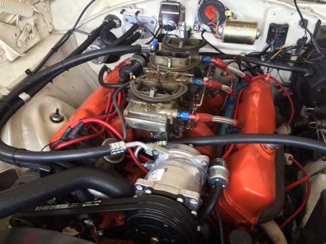

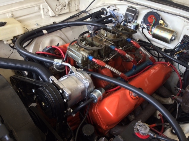

Here are some pics of the one I just installed.
Thanks for the reply, did you have much trouble with vacuum controls
I was missing one vacuum controller so I had to find one on Ebay. I also had to replace the vacuum line that runs out to the vacuum canister under the battery tray and the one that runs from the battery tray to the intake manifold. Other than that, the vacuum lines and control pods under the dash still worked okay. I also ended up buying a new push button controller because my old one was a little rough.
Nice job I like the fact that you still use the double belt set up with out much alteration

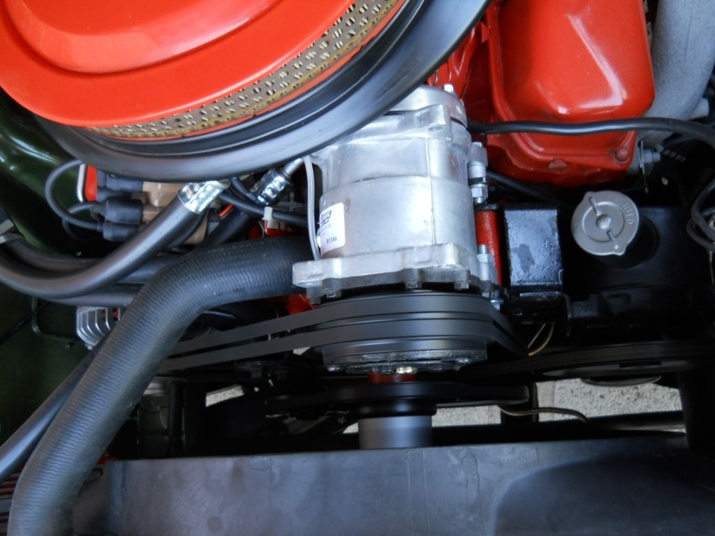

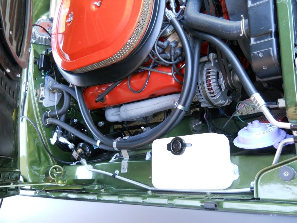

I did one a couple years ago on my 69rr factory ac car, it was very easy & clean I got everything from classic air that was a upgrade kit with extras since most of my parts where missing & it sat open for years. I think I had about $1500 into the entire deal & that's with having my hcv restored.
Very nice, is your heater valve vacuum actuated and is it a replacement?
The heater valve is controlled by a cable, but also has the vacuum pod (I'm not real clear on what the vacuum pod does). I sent the heater control valve to a guy in California for a rebuild. He did a real nice job for about $125.
