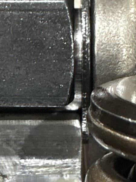

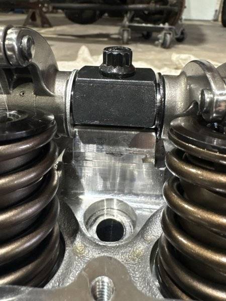

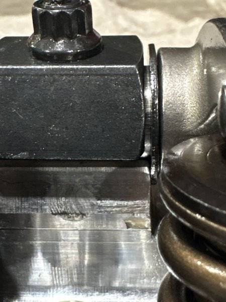

installing heads on a 440 ran into an issue or maybe not an issue depending on what you all say.
Heres what im working with.
My parts - trickflow 270 mw heads and prw roller rockers 1.6 stainless steel.
Issue ? - the heads rocker shaft pedestals are wider than the rocker shaft caps from prw. Causing the bottom half to be in spec of .015 free play. However on top by the caps there is a .03 or bigger gap (eyeballed the gap). See pictures for reference. Note the black shim is .03 thick.
Anyone else have a similar issue with other brands of both rockers and heads?
Whats the course of action? i really dont want to shave the pedestals down on my brand new heads.
This has to be a big concern. Curious to see what you all think.

What Has TrikFlo Said When You Called Them ????????????????????????????????????????????
If I had 270 heads to play with I'd use the proper rocker assemblies. Prw sounds like a cutta corner.
I would not worry about it. You have the thrust washer there to take up clearance. What I would be concerned with is that the roller tip is centered on the valve, & that may require r/shaft shims.

Have the 240 version of the heads and the same rockers. Used different hold-downs (B3RE) as I encountered the same issue. The bigger issue though was that the roller tips were not centered on the valve tips! I had to machine down the rocker bodies to properly center them (either the rocker bodies or the pedestals are too wide).
EDIT: I'm talking about the left/right alignment
You have to get the right/correct hold downs. The shim will chew the alum pedestal. It will eventually cause pretty nasty problems - rocker misalignment, shaving in the oil, etc. 440 source's hold downs tend to work well with TF heads... 240's and 270's.
Its a long shot BUT ... there are two different widths of holddowns - 6 narrow ones and 4 wide ones. Are you using them in the correct spots ?
Shims didn't work? Im assuming you needed to move it down to move the rocker on the valve the right way. Mine are sitting dead nuts in the center of the steam at closed.
Side note... BTW.. 270 heads with 1:6 rockers... that will flow really nicely... curious as to what intake and cam you're running.
I think that my 190's on my Small block were the same, I haven't had any problems. Did use B3's geometry kit.
Was talking about the left/right alignment not the up/down. The rocker bodies hit the pedestal (no shim used) and were still off from the valve stem - no way I could have centered it without removing material somewhere (rocker body or pedestal).
