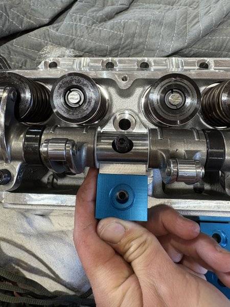

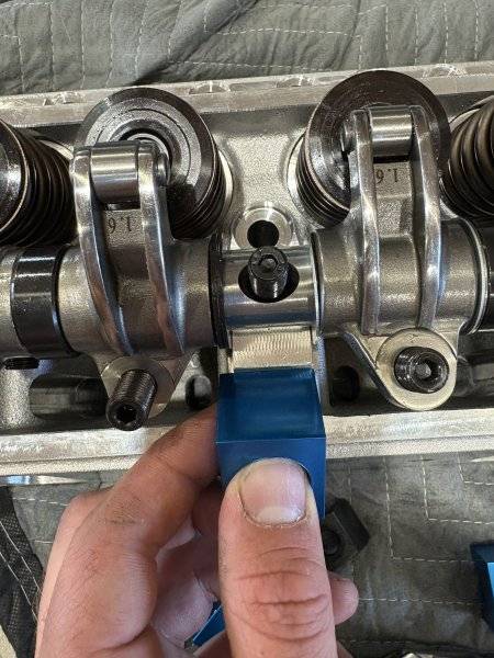

Aftermarket head / roller rocker not mating together
I had to do surgery on the outer pedestals with a set of 240s once.. for a set of comp ss rollers.
The shims will wear the alum pedestal, post #8? Don't think so.....
The original 1958/9 factory heads came with alum blocks pushed onto the shaft & acted as the hold-downs. No shims used, rockers in contact with the alum..& no wear. Not sure what year the alum blocks stopped.
