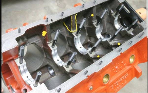

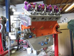

I have a stock 440 block, all machined, of course.The "panda bear eating popcorn" pic is because I am actively planning a stroker build.
If I forego nitrous, my HP and Torque goals are in the 6XX range, and I believe that a girdled properly setup Chrysler block would be fine. If I want to add nitrous, I would want an aftermarket block. I probably only have one shot to do this, would prefer to only build this motor once, 6XX HP and TQ may be all that I can handle, but....
So I am attentively following this aftermarket/or not 440 block search as well. Thanks to all who reply.
I have a 440 source steel billet girdle and 440 source steel billet main caps. Ohio Crankshaft Crank, H-Beams Rods and SRP Forged 12.2-1 Pistons.
When I originally built the motor it only made 602HP on the engine dyno. I have made significant power upgrades since then, but did NOT put it back on the dyno.
My motor must make about 740HP to get my 3800lb Coronet to my personal best ET and MPH just this last weekend of 10.170 @ 131.50. (According to Wallace Computer Website, which is pretty darn accurate.)
I am always told that if one goes OVER 750HP you are looking for trouble even with the upgrades that I have.
