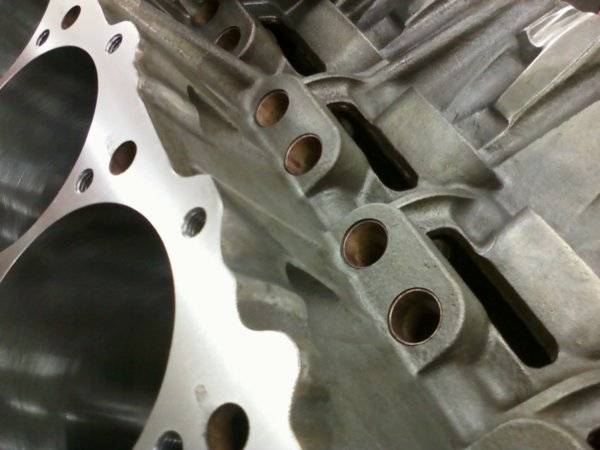

My mega block has been great. There are early and late. From what I understand you want the one with this triangle logo and the ribs in the lifter bores

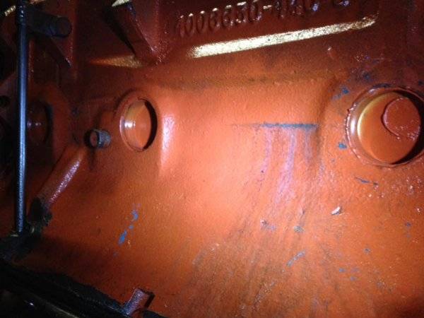

You could get that crack metal stitched for about $200.00. Wouldn't even have to disassemble the engine. Then just beat the hell out of that motor while you take your time and build the motor you really want.
Another vote for stitching what you have. The location of the crack doesn't appear to be in a location that would prohibit stitching. If it was in the deck or the Main webbing than it would be trash but where its located you can stitch it and probably get a couple of more seasons out of it.
